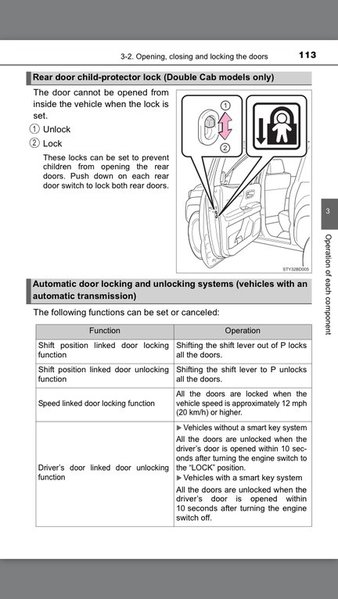

    Page 113 of the manual: it is set to lock at 12mph, and can be set or cancelled. Check the head unit.

    saw this in the manual but it says for auto transmissions only... Ill check the head unit...

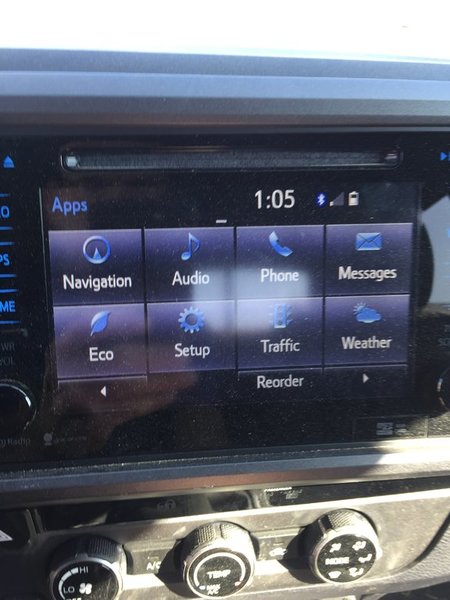

    I have the MT, on my head unit push apps then push setting scroll right to vechicle then door locks.

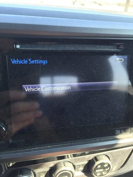

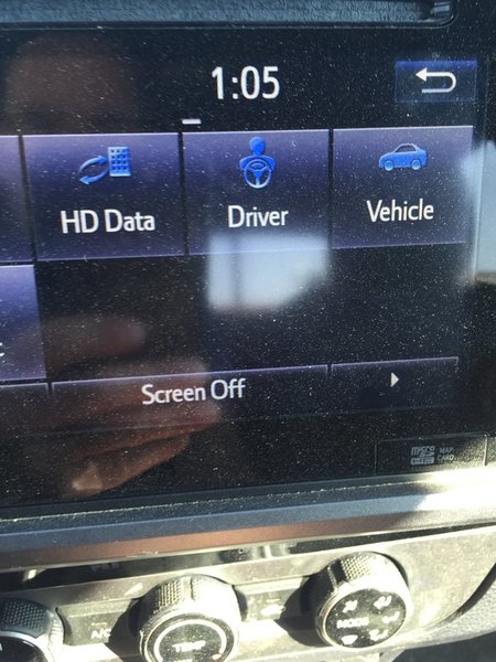

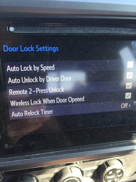

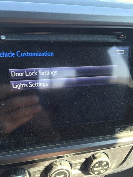

    Now I can do it with pics
    Click setup
    Click vehicle
    Click customization the truck needs to be running in neutral I set park brake not sure that is needed. At this point if it's grey give it a minute to communicate with itself. Mine turned white less than a minute.
    Click lock settings
    Uncheck 1st one as I have done.

    None
    Unlock drivers door unlocks all, there is also some light options like how long dome light stays on as you walk away. You can turn off daytime running lights.

    I don't know what auto relock is so I turned it off.

    auto relock is if you accidentally unlock your vehicle, it will automatically re lock itself after a certain time period as long as you don't open a door
    my FR-S had the same option in techstream; i turned it off :p

    hmmm, dont think the SRs have this option, as as far as I can tell I dont have a "driver" app
