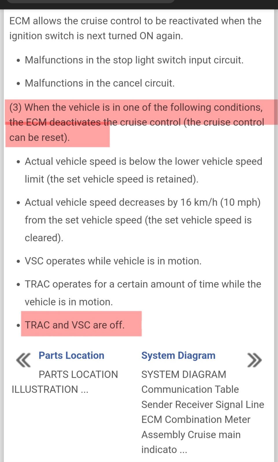

  13. Mar 18, 2024 at 4:06 PM
    wilcam47
    wilcam47 Keep on keeping on!
    Jan 27, 2016
    #176243
    54,196
    Will
    Bourbon state
    https://www.ttguide.net/system_description-1120.html
