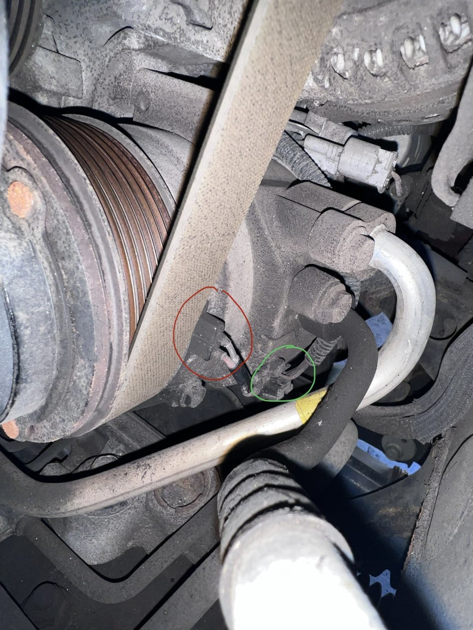

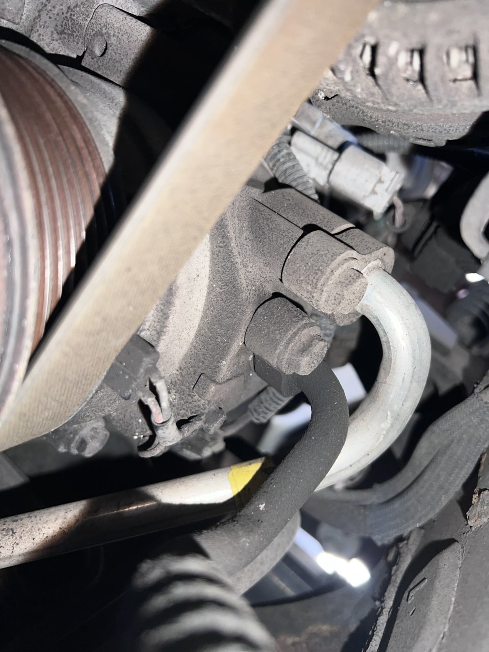

    This puppy?

    See if you can reach down and move the mag and wires

    Hard to tell the angle where it’s suppose to be in that shot

    Reached down and the wire connections I circled in red are super tight in there and I couldn’t tell if the wire disconnect I circled in green was good or not. I think I might need to take the skidplate off for that.
    so you think it’s the wiring or should I start ordering a new compressor?

    The crap that’s on the line and on the face of the compressor looks like it might have separated.
    I would disconnect the clutch connector and see if the fuse blows.
    Can you turn the outside of the compressor with your hand?

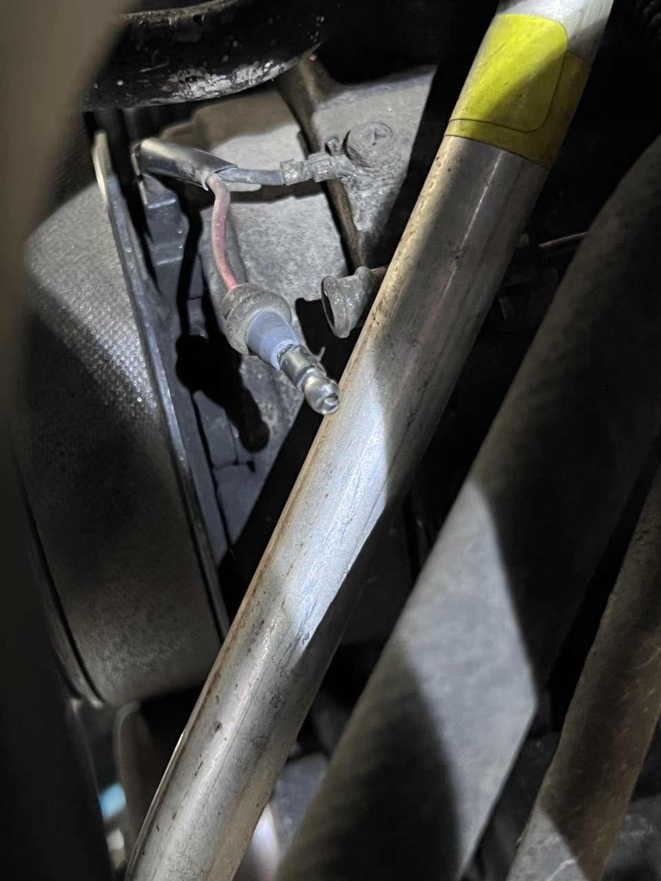

    How does this connection disconnect? Do I just pull out or is there a tab? Or should I disconnect it at the green circle disconnect?

    You might as well take the skid off.
    Follow the wire from the clutch to the connector. I think it’s white. There is a tab…

    Ok with the skid off I uplughed the clutch and it didn’t pop the fuse. The second I plugged it in it popped the fuse! So looks like my compressor clutch is the issue! Thank you so so much for your help! I appreciate it so much!
