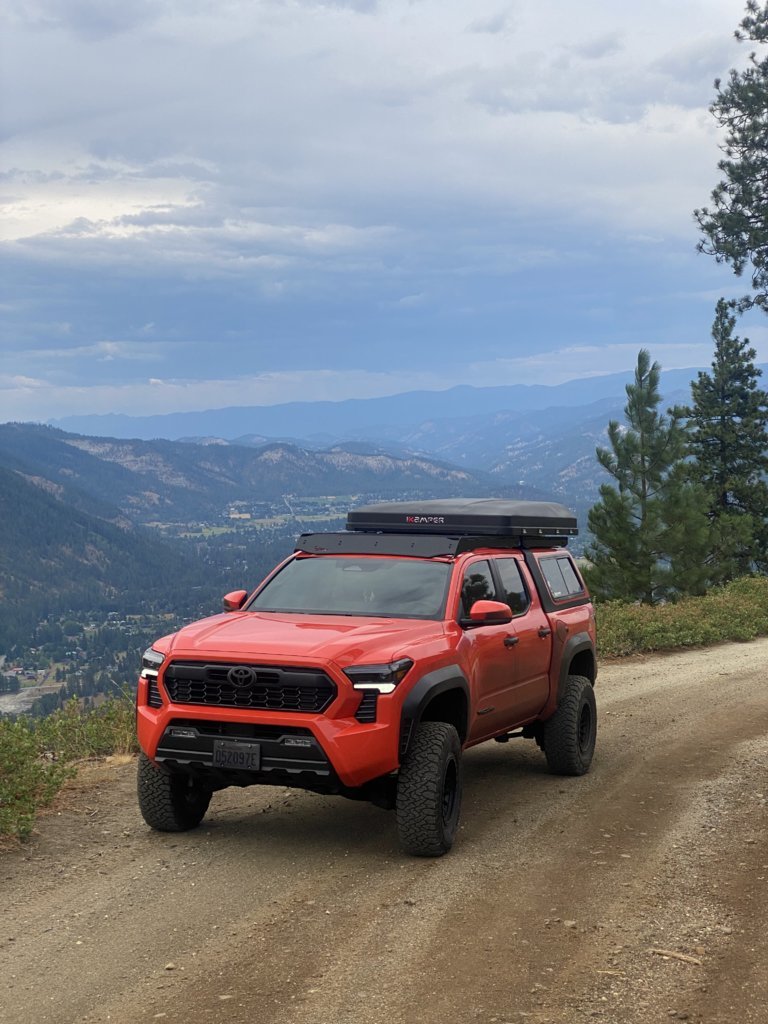

    Curious if anyone has noticed decent amount of turning radius reduction with a 2+ inch lift and 0 offset wheels? My rig doesn’t like full turning anymore lol. I guess the 0 offset wheels is to blame extending the wheels further out or if the lift also plays a factor. The turning radius was already bad enough stock!

    I also think my CVs are not liking the lift and ICON diff drop I had installed. A lot of binding felt when turning which I think is the primary cause of the diminished turning radius (not so much the wheels). Had the shop who installed it check today as well and they noted the same thing.

    So I had 33s before the install and no change to the turning radius.
    After the Dobinsons suspension install and new wheels, full turn is much harder to maneuver. Almost feels like the CVs are binding as well which is not great. I have the Icon diff drop installed but not sure if it helped with CV angles. Going positive on offset seems like a small change I can do to help the turning out a little

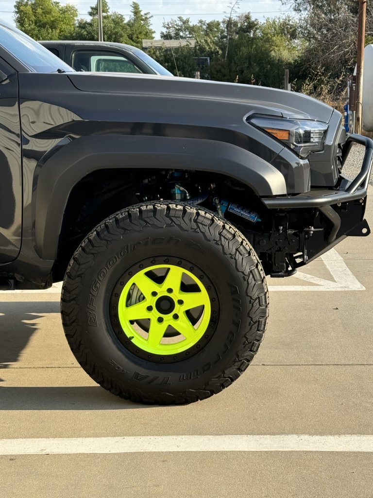

    as wide as I wanna go. -10.
