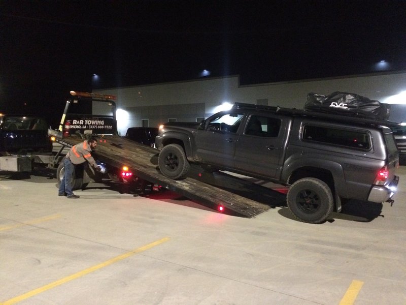

    TUROK won't come out of park.... 10k miles. Thankfully Toyota is taking care of everything. We shall see ...

    What? That's crazy

    Daaaayum.... That sucks. I'm sure you'll keep us posted.

    TUROK looks damn good on a flatbed still :cheers:

    Hate to see him up there though.... :(

    So here we go..... I got into my truck yesterday afternoon and it would not come out of park. Being that my truck only has 10k miles on it i immediately called the local dealership to get this taken care of. They ensured me that whatever was wrong would be covered under warranty and they advised that i use the Toyota Care road side assistance to have my truck towed to their lot so they could repair it. They gave me a rental and everything. So they called me this morning to let me know that they had found the problem but nothing was going to be covered under warranty...... So it turns out that the wire that the camper shell shop had tied into my rear tail light had been rubbing on a metal piece in the tail light cavity. The wire eventually wore through and ended up popping a fuse in my truck. This disabled my tail lights and the brake switch that unlocks the shifter console when the brake pedal is pressed. Soooo......Make sure that the wire running from your tail light to your shell is well insulated and away from any sharp edges. That 1 little wire pretty much disabled my truck....... Have a good one!

    Sounds like the camper shell place owes you for a tow and a trip to the dealer.

    Oh yea they made it right. Toyota took care of the tow and the rental and the camper place reimbursed me for the repair and hooked me up with a set of weathertec floor mats for free for my trouble.
