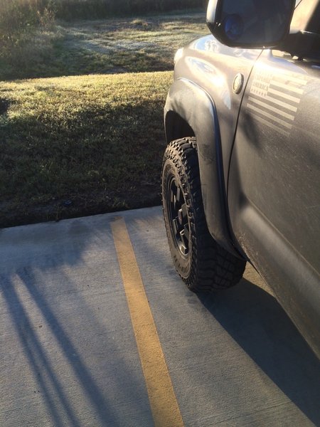

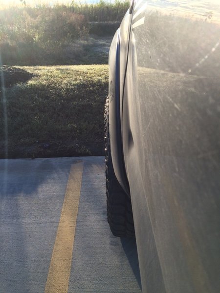

    Put some 1.25" spacers on the front last night.... not sure i like them. I wasn't rubbing but not I am which is weird. Thoughts......?

    Where are you rubbing?

    Back of the fender on the drivers side.

    Just trim that little piece of plastic off that's what I did.

    I wouldnt run spacers unless you need them. Maybe just keep them on the front and take the back off?

    I don't "need" spacers... I was just bored haha. I only have them on the front. When I lifted it the front wheels kinda sucked in a bit because of the steeper control arm angles. I was trying to fix that but screw it. I wasn't rubbing before and I am now so I'll prob take them off

    If you like the look better just trim the little piece. Little more stance.

    We shall see. If when I go offroad the rubbing is even worse then it's not even worth messing with to me. I have no rubbing at all with no spacers so...

    Adjust your caster to be more positive and the rubbing will go away. With the wider stance it makes the tires tuck differently and will rub. I just went through the same thing when I went to a wheel with 3.5 BS. Did the whole Cab mount chop, cut plastic, remove mud flaps and everything to get it to not rub. Then adjusted the caster and found that none of the trimming or cutting was necessary.

    Yea...The outside of the fender is tighter than the inside.

    4 degrees of caster is ideal for off road.. Currently sitting at the shop getting my truck aligned and hoping he knows to max it out, not go stock.

    My caster is at about 3 right now which makes the truck ride sweet off road but is currently giving me some rubbing on the rear of the front fenders

    rubbing the back of my tire against the wheel well side of the back of my front fender...... :anonymous:
