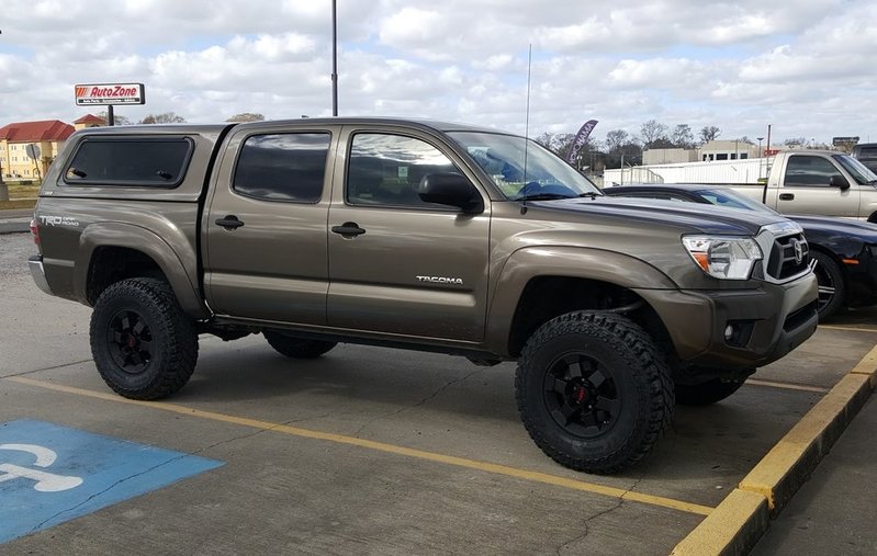

    What does your lift consist of @Volunteer ? really like the stance

    he has a similar setup as mine except the rear leaf pack is the OEM 4 leaf with an AAL from wheelers. And he is running the OEM coils in the front with the adjustable Bilsteins all the way up. Soooo....
    Front:
    Allpro Upper Control Arms
    Bilstein 5100s (set all the way to the top)
    OEM TRD OR coils
    Rear:
    ATO shackle flip kit with HD shackles
    Bilstein 5100 LT shocks
    OEM 4 leaf pack with wheelers AAL
    Allpro extend brake lines
    Allpro Ubolt Flip kit
    Great looking truck!

    So he's not running the OME Dakar leaf pack, He's running the Stock OEM with a AAL from Wheeler's ?

    that is correct. I believe his plan is to eventually go to the dakar pack but for now he is currently running the OEM pack. The Dakar pack is a 7 leaf pack and the OEM is a 4 leaf. So he is running a 5 leaf pack with the AAL which is why his sits slightly lower in the rear and looks more level than mine. I have quite a bit of rake on mine because by the time i load up for a trip with all my gear and the RTT on top a am pretty heavy in the rear and need the extra support. Just depends on your application.

    His also may settle a little bit in the rear after a while. But AALs are cheap and easy to install so....

    wow that looks high for an AAL

    he also has the Shackle flip which gives .75-1" It really did come out good. He is a practical guy and i respect that for sure. In my opinion leafs are leafs. They are pretty basic and they can easily be adjusted to fit the need of the user. Ive actually been considering removing one of the leafs from my pack until i get a rear bumper on there. I have a pretty significant rake going on.
