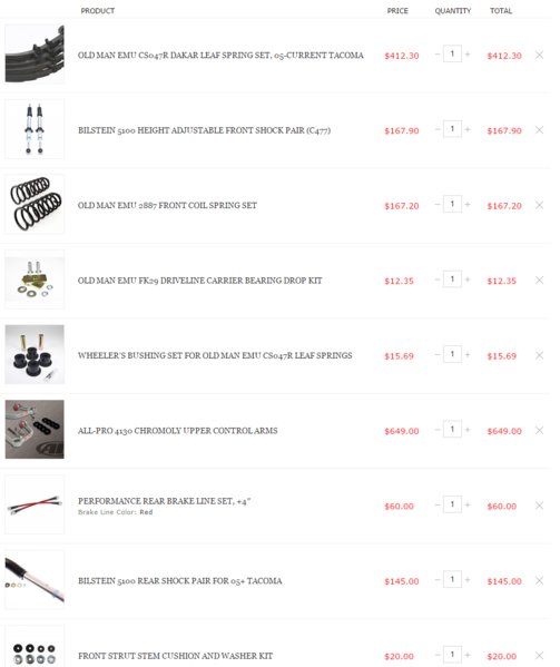

    Cooper ST MAXX ordered.... 255/85r16 FTW!

    I have my wheelers cart built..... lift will be ordered this afternoon!

    Why the 5100 on front and not OME if your are gonna run 887 coils?
    Not going with the extended rears?
    I would sans the CB drop kit and use washers to make sure I got it perfect but others have had luck with the OME spacers.

    I didnt have good luck with the OME shocks. I put the 5100s on my truck right before I traded it in :facepalm:and really liked the ride. Also liked the 887 coils. I had the OME CB drop kit on my last one and had no driveline vibes. I'm going with the normal 5100 rears because I don't have my shackles flipped yet. It will be an additional $400 to flip them right off the bat.... Not sure if I'm going to do that yet. I'm worried with the dakars and shackles fliped without a rear bumper I will have some serious rake on my hands. I haven't ordered yet. Still debating.

    Then again... i dont want to buy shocks twice... you guys are the worst!!! (but the best :thumbsup:)

    07 PreRunner SR5 DCSB
    billie 5100's front @ .85"
    subbed - my truck has 5100's set at the .85" "level" setting and OEM springs and I feel like it rides like a log wagon.

    just curious why you are choosing the all pro uca instead of LR uca's? are they beefier, align better, or just personal preference?
    just wondering because ive heard the uniball type uca's squeak a a lot and start squeaking early on. and you have to use a lot of that lube or spray whatever it is to keep them from squeaking.

    Little beefier. I also prefer the uni ball over the ball joints. I've just heard that the ball joints wear out and don't have as much articulation as the uni-balls.

    Suspension.............ordered
    shackle flip............. ordered
    HD shackles.............ordered
    Tires........................ordered
    Wheels.................... ordered
    CB radio................... ordered
    Shell......................... ordered
    Racks........................ ordered
    Alright.... Im done for a long while now.

    Jw why you ordered the allpro uca's? You can get TC for the same price at Downsouth Motorsports. Not saying anything bad about allpro.
