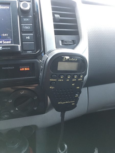

    Good morning superstar. What can you tell me about your Cobra 75wxst? I don't know jack about cb's but think it's a important mod for going out in remote locations. Could you also tell a brother what all would need to be purchased along with the radio?

    What the heck. Cobra 75 WXST
    Small hide away CB Radio. The radio itself is a small, silver box that is meant to be hidden away, such as mounting under the dash, a seat, or a center console. All of the controls for the radio are on the Mic. This also means a generic CB Mic won't work with it as they don't have the CB Controls.
    You will also need an antenna cable of appropriate length, and an antenna, and an antenna mount. Antenna type and mounts vary depending on where you want to install it, how long the antenna is, etc...
    You will also need to "tune" the antenna. To do this you will need an SWR Meter. You can find them for ~$10-20 and the included instructions are not terrible. If you key the mic on a CB without an antenna attached, or with an antenna that is far enough out of tune, you can actually destroy your radio.

    Yes sir, I have been looking at some of those threads. Trying to glean some knowledge. Mr. Dino slayer has one of the model/brands I have been looking at, so his first hand info of it's practicality(all the buttons and bs on the mic) and model specific parts needed.

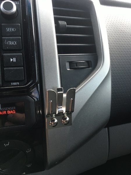

    Sorry dude I was on vacation. I like the 75 a lot. It's small and works fine for my application which is vehicle to vehicle coms and emergency weather and trucker chatter. It was really easy to set up. You will need the CB obviously, a coax cable, an antenna mount, and an antenna. That's pretty much it. Pick out where you want to mout it and go for it. I'll try to find the write up I used.
    This is where I mounted the mic....
