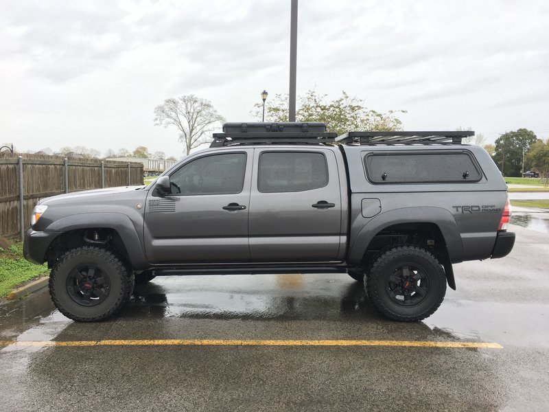

  8. Mar 5, 2017 at 10:26 AM
    #1848
    Juforrest
    Juforrest Dumb!
    Nov 23, 2015
    #170434
    5,943
    Justin
    Seattle
    Reformed Taco driver in a GX460
    Also need a pic of truck.
    ChadsPride and ragincajun35[OP] like this.
  9. Mar 5, 2017 at 10:44 AM
    #1849
    ragincajun35
    ragincajun35 [OP] Well-Known Member
    Jul 4, 2013
    #107595
    3,001
    Spencer
    Louisiana
    2015 DCSB MG TRD Offroad
    See Builds....
    I don't remember what stock ride height is anymore lol. Tempted to go to the dealership with a tape measure. I'll get a pic soon
    ChadsPride likes this.

  11. Mar 5, 2017 at 12:00 PM
    #1851
    ragincajun35
    Jul 4, 2013
    #107595
    3,001
    Spencer
    Louisiana
    See Builds....
    Still about a 2" rake. I like it. Fresh rubber will be next.
    99TacoDriver and ChadsPride like this.
  12. Mar 5, 2017 at 12:04 PM
    #1852
    Juforrest
    Juforrest Dumb!
    Nov 23, 2015
    #170434
    5,943
    Justin
    Seattle
    It must be the shorter wheel base that makes some trucks look bigger. Looks good.
  13. Mar 5, 2017 at 12:34 PM
    #1853
    ragincajun35
    Jul 4, 2013
    #107595
    3,001
    Spencer
    Louisiana
    See Builds....
    It's all an illusion! Don't believe TW.

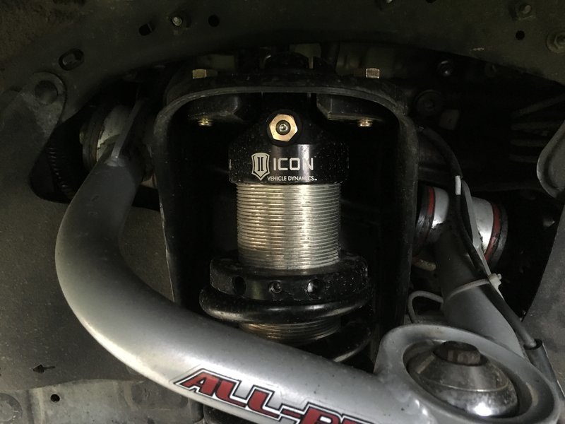

  15. Mar 7, 2017 at 5:48 AM
    #1855
    ragincajun35
    Jul 4, 2013
    #107595
    3,001
    Spencer
    Louisiana
    See Builds....
    Adjusted my coilovers to 1.8" uptop whih yielded 23"-23.5" hub to fender. My truck is currently riding like shit. I hope that at the ride height I want it is not too much preload on the coils. It looks like a lot compared to many other setups I've seen. Need to get another alignment after I cranked them. I'm also starting to suspect that it may be my tires......
  16. Mar 7, 2017 at 5:51 AM
    #1856
    99TacoDriver
    99TacoDriver Well-Known Member
    Jul 8, 2011
    #59531
    6,882
    South Louisiana
    OME 885x/5100s/LR UCA/3 leaf AAL/275/70/17 Terra Trac X-Venture
    The tires can also have an effect on the shitty ride. Once I got new tires and aired them properly it was a huge difference
    ragincajun35[OP] and ChadsPride like this.
  17. Mar 7, 2017 at 9:45 AM
    #1857
    Juforrest
    Juforrest Dumb!
    Nov 23, 2015
    #170434
    5,943
    Justin
    Seattle
    I'm pretty sure the sweet spot for those is 2.5" of lift.
  18. Mar 7, 2017 at 9:46 AM
    #1858
    Juforrest
    Juforrest Dumb!
    Nov 23, 2015
    #170434
    5,943
    Justin
    Seattle
    Are you at max adjustment?
  19. Mar 7, 2017 at 10:23 AM
    #1859
    ragincajun35
    Jul 4, 2013
    #107595
    3,001
    Spencer
    Louisiana
    See Builds....
    Max adjustment is 2.13" of threads showing. I'm currently at 1.8-1.9"
