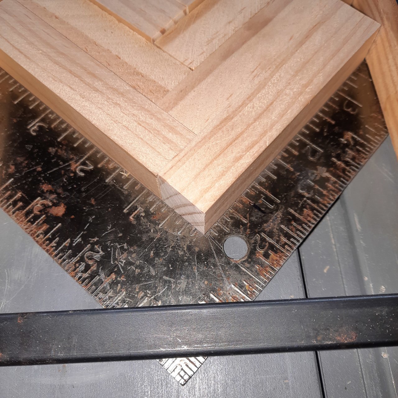

    Herringbone pattern, but its a disaster!
    :eek::eek::eek::yes::yes::yes:

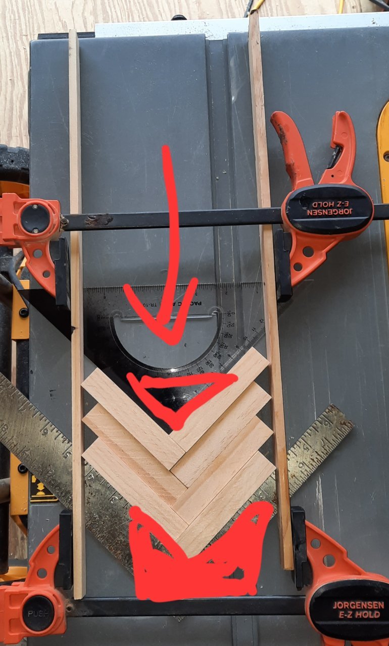

    Ok hope this helps...
    All your pieces need to be same length and ends squared.
    Bottom filled in piece needs to be exact 45° smaller than the pieces you are glueing and mounted to a flat board
    The top 45° piece needs to be loose.
    The sides need to be loose, can be anything so long as its flat on one side...towards the cut piecies you are glueing.
    You really need a dedicated jig for this.
    Your test piece looks like the top 45° had too much pressure or sides didnt have enough.

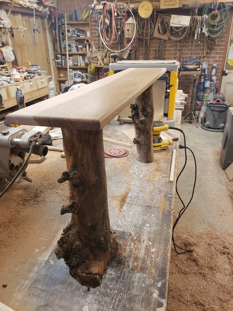

    What do we think of this? Applewood logs and hickory for shelf piece. Was thinking of my desk that needs a piece like this to sit on top so I can make some space.
