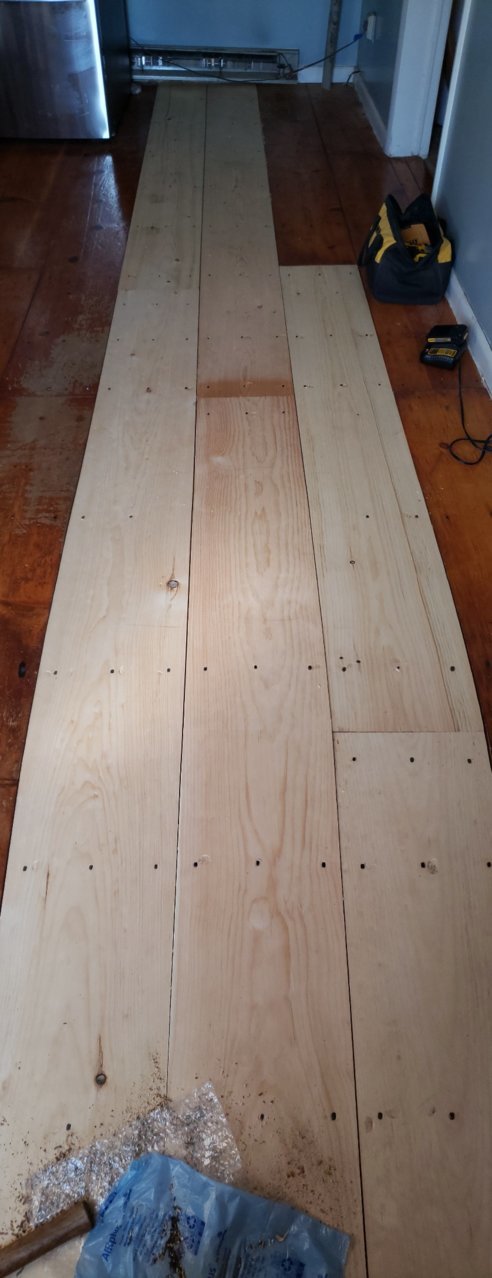

    Here's where we are.
  16. Aug 20, 2023 at 2:40 PM
    #6576
    tclavell
    Aug 7, 2020
    #336897
    12,515
    Troy
    Phoenix, AZ
    G70
    You going to rent a floor and edge sander and sand and stain the entire floor or just that section and blend in the new boards?

    Renting a floor sander. Doing the whole floor then staining to match the other floor and varnish. :goingcrazy::goingcrazy::goingcrazy:

    The best way! Go with a 35 grit first pass, 50 second and 100 for third.
    Then use a buffer and 120 grit screen to finish it off. Then vacuum dust.
    For edging, 50 and 100 should do it.
    Just let that floor sander do the work, feathering in and out when you get close to the wall.
    You may have the do a 45° pass over new wood first if the lip is high enough from what you tied into.
