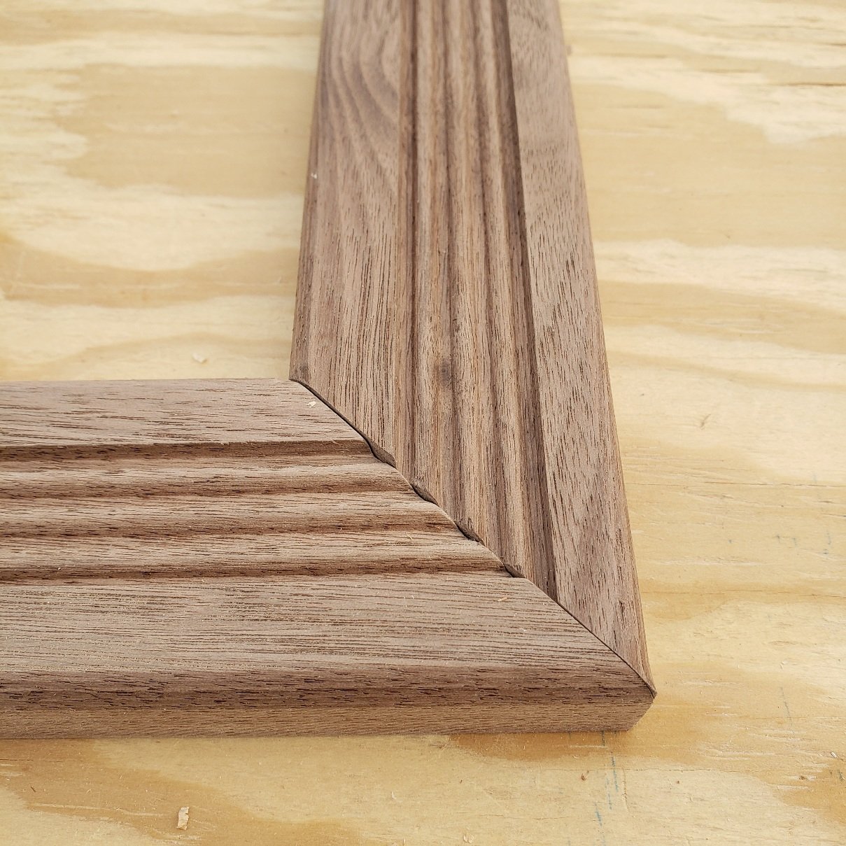

    Starting off the day with tears!
    This side lines up perfectly. In fact 3 of the 4 pieces line up absolutely perfectly.

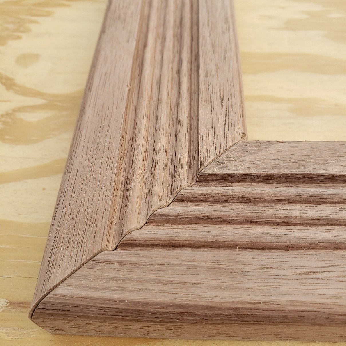

    Then there's this side. I realized when I cut the angles, this piece was backwards, so the thick side is on the inside here instead of the outside. :facepalm:
    My frame! My beautiful frame! Whatever shall I do with you now??? :(:(:(

    Make a smaller frame ... still sellable. Flip the inverted piece around and cut it the correct direction at 45. cut the piece opposite the mis-cut narrower to match. Cut the other two sides down if the frame would be too oblong as a result.

    Got more frame material? Make a different frame with the mismatched piece.
    Also might help you to get a piece of chalk and draw a line on the angle you want. Chalk wipes off.
    Dont beat yourself up...it happens;) i still make mistakes...

    The frame I can make smaller frames from, but I can't use it for the purpose it was made for which is a bummer cause the rest turned out so well. Obviously not the end of the world though. I'm gonna try again on some hickory since I have enough of it for another frame.

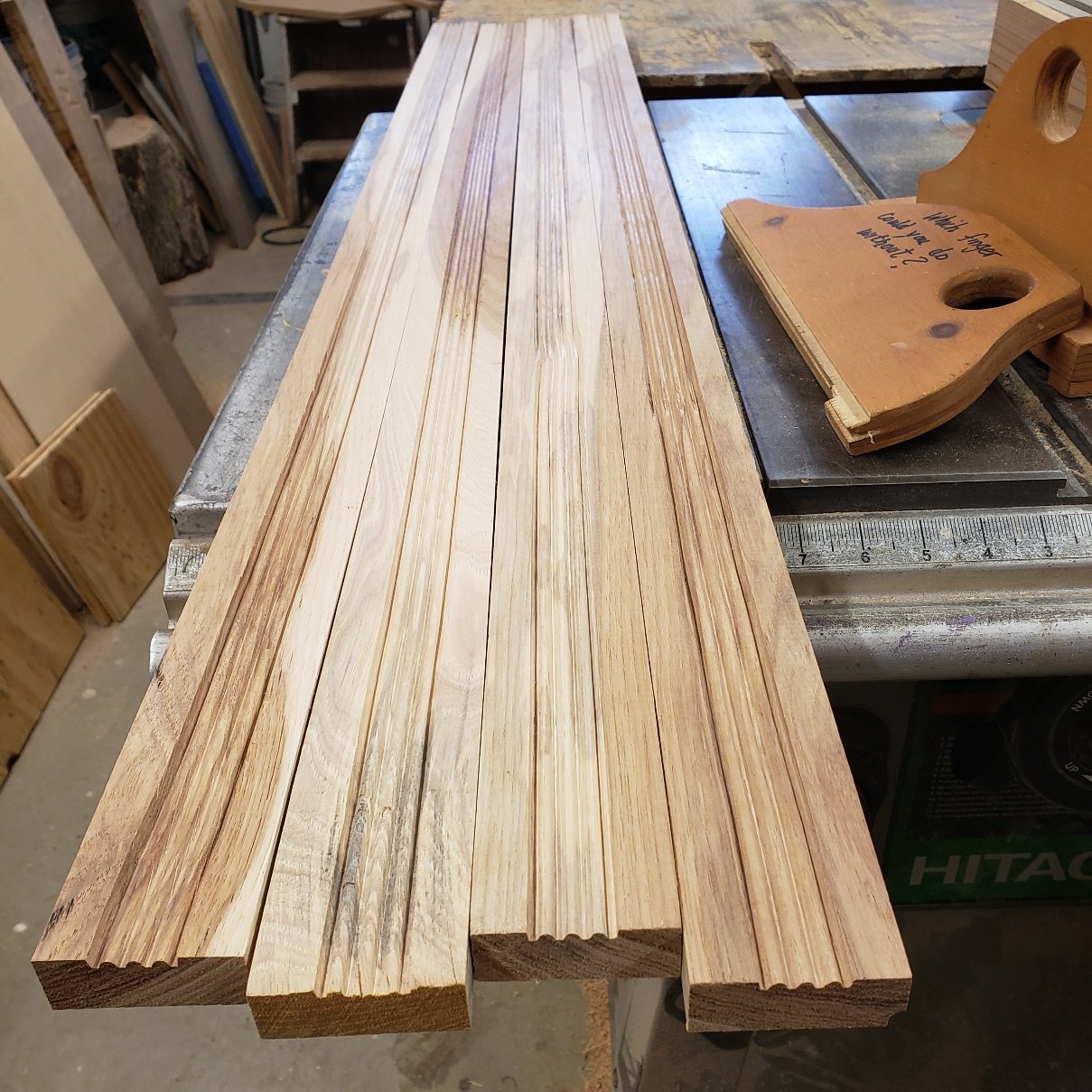

    Gotta face this guy again. :fingerscrossed:
