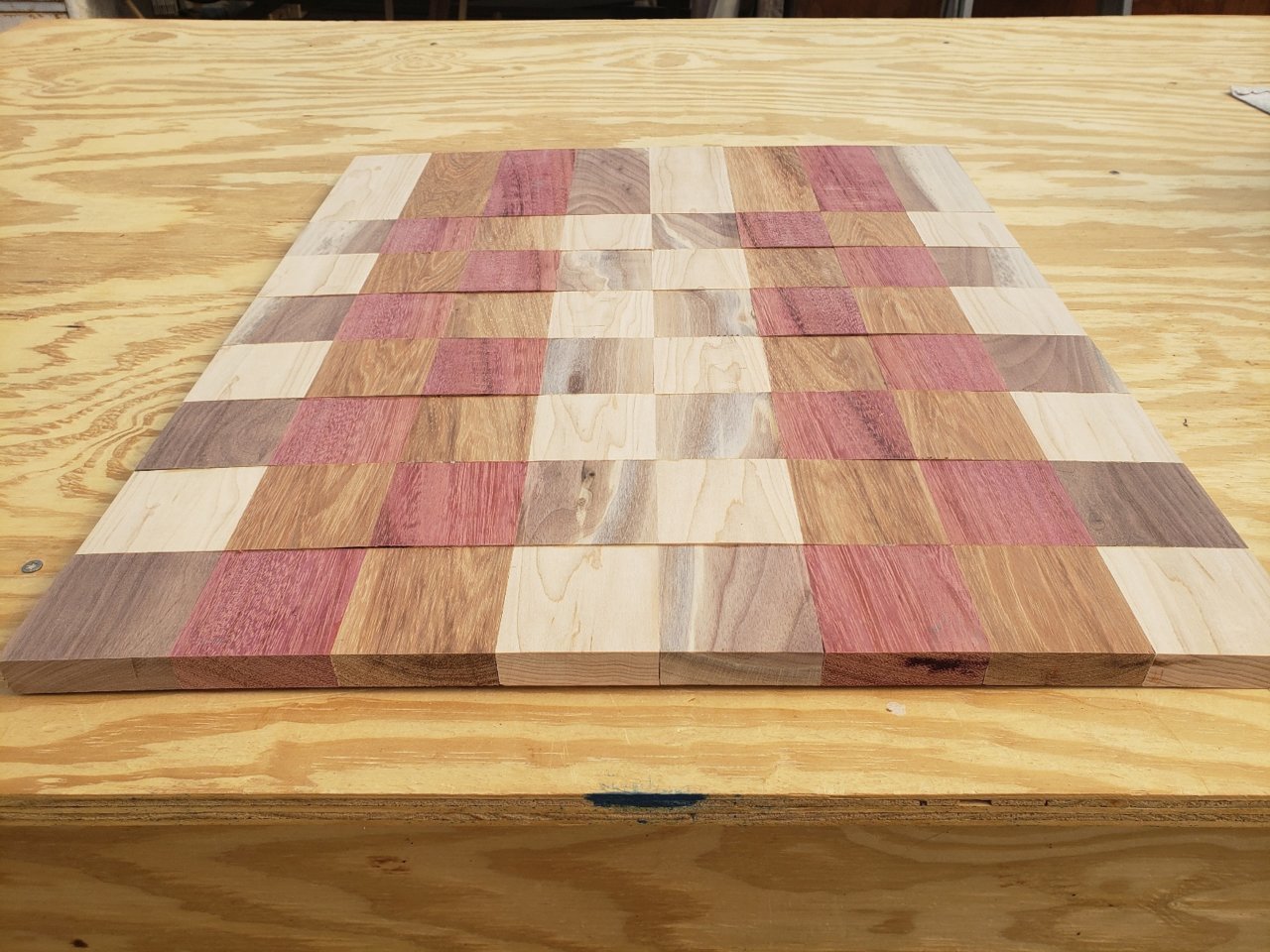

    It bowed :(:(:(

    Is it glued?

    Yes.

    Wet down both sides with a soaked washcloth or paper towels then stand it on end to dry...it will come back to shape

    I see it in thin boards. Let it dry and its Best to use a clear finish like salad bowl finish for cutting boards or clear poly for chess boards

    Looks like that helped some. We'll see what sanding reveals tomorrow.
