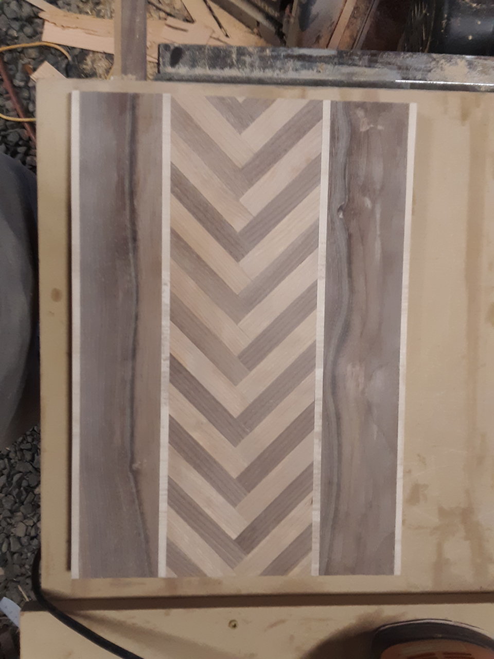

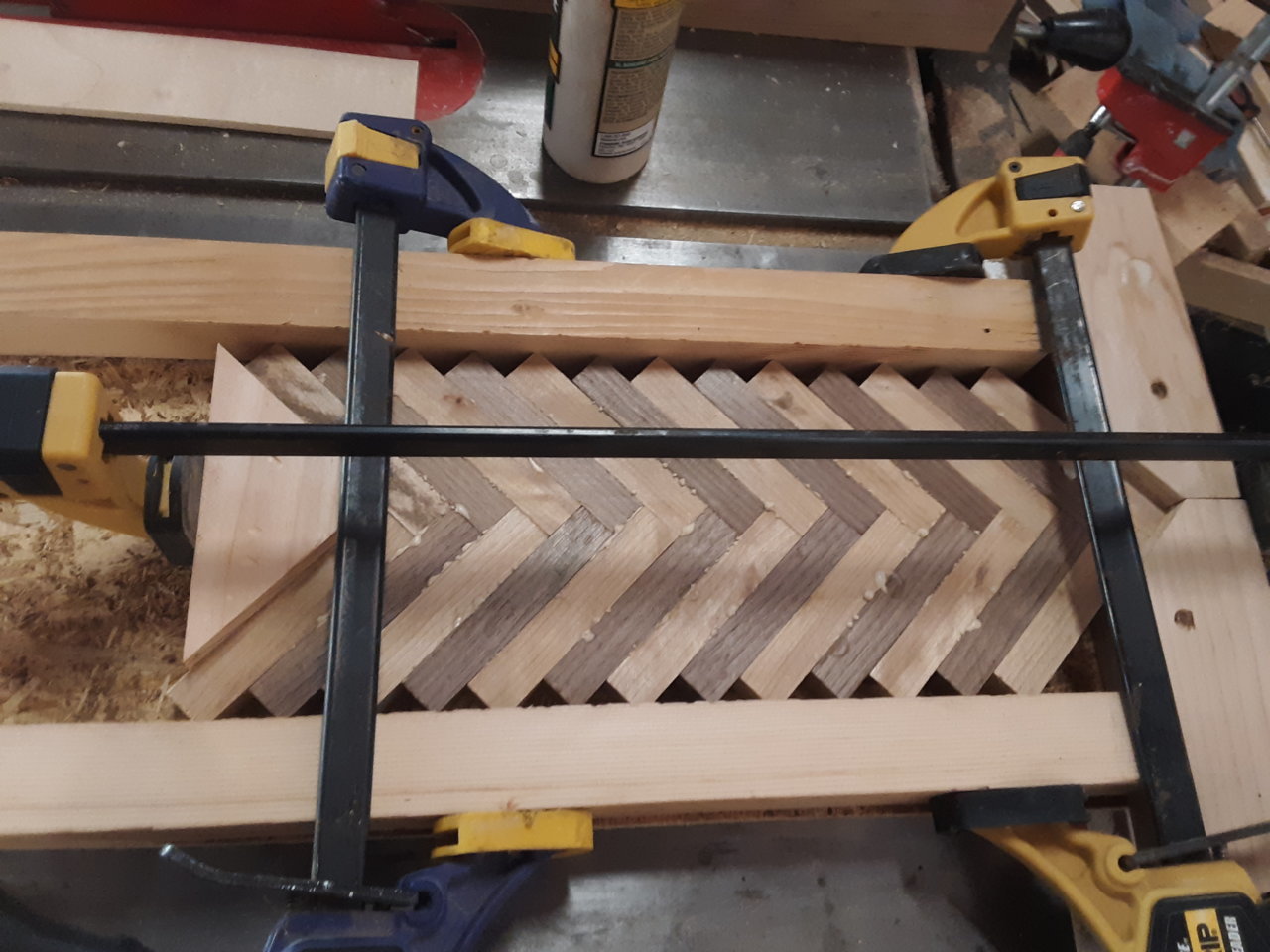

    Heres a herring bone cutting board. Give you an idea on jig. Cut the pieces the same length and make sure ends are square. Put some wax paper down then Glue in the jig. Then when that dries, cut the ends on table sawthhen glue like normal and square the ends

    I'm gonna try that!! :fistbump:

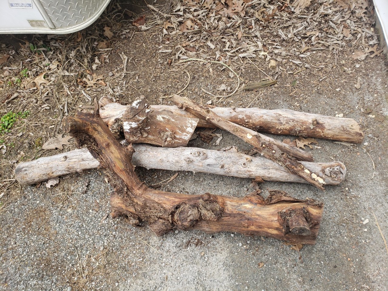

    I think I'm going to check my apple wood logs this morning before I go up to the shop. :)

    Its not impressive, but they will be joined by more when I empty my truck and go up for more.

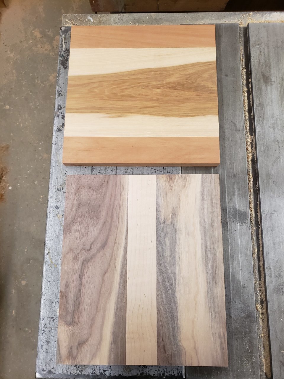

    New boards planed and squared.

    Is that hickory on upper one?

    Yes it is! :):):) I love it!

    Its really nice!

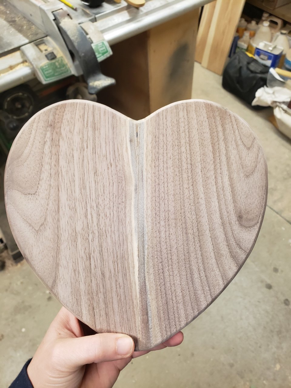

    What should I do with this little one? Leave it as is now that I finished sanding? Or make it darker?

    clear coat, sand, clear coat, sand, clear coat and done! :fistbump:

    Darker. Don't listen to Troy. :smack:
