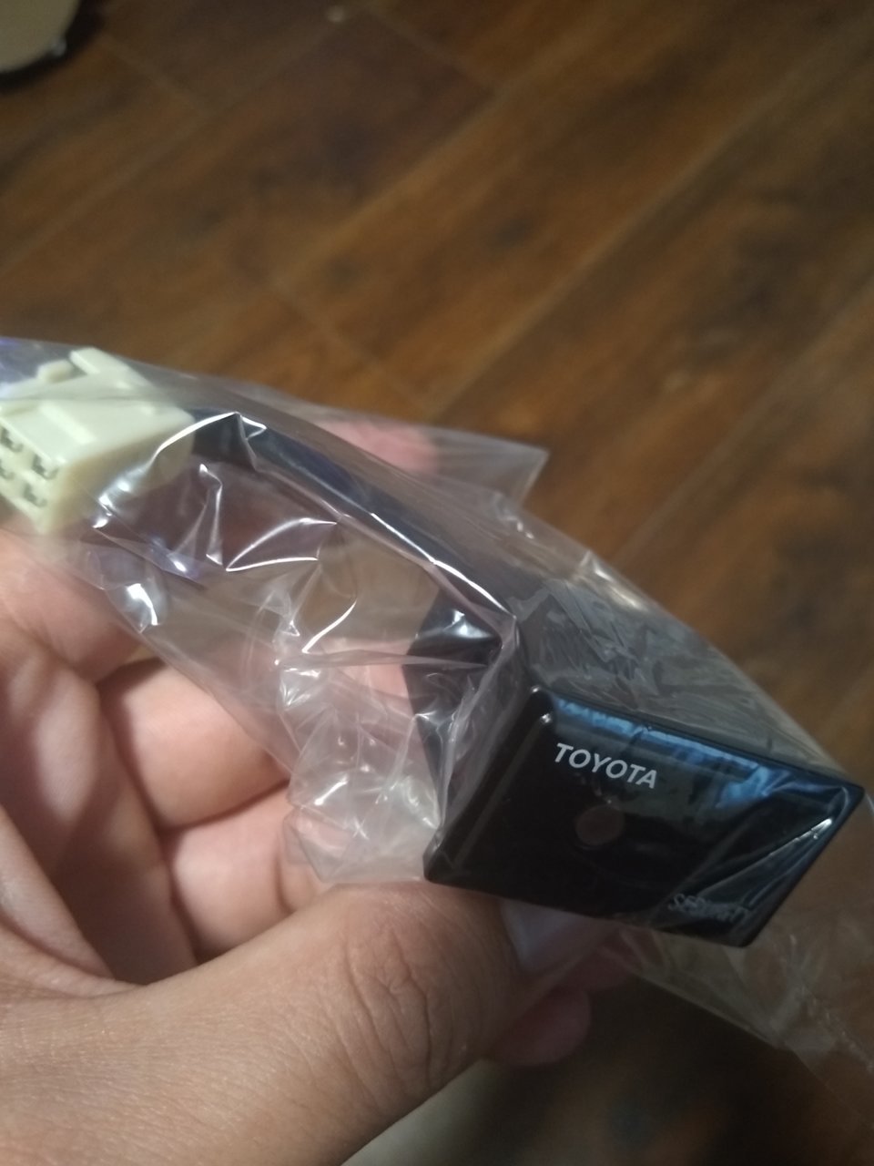

    I was able to order the part at Camelback Toyota, this is what I got.
    Is this all I need to "upgrade" my keyless entry systen on my 03?
    I was expecting another module.

    tacotime1
    tacotime1 Well-Known Member
    Apr 8, 2010
    #34849
    575
    That’s it. It just plugs in.
