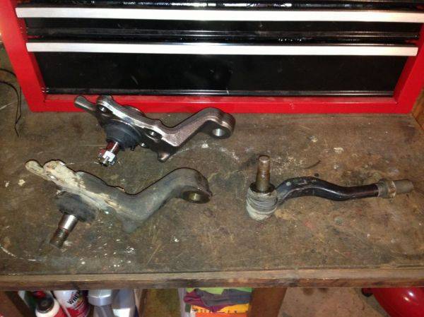

    If I didn't have the nut on there I would have most certainly fubared the threads on the part I am not replacing. Again, not replacing outer TRE, only replacing lower ball joint.
    1st gen. Outer TRE is attached to the hunk of metal (whatever it's called) that the lower ball joint is pressed into. Replacement lower ball joint is the whole thing. So I need to detach the outer TRE, remove four bolts attaching ball joint to spindle, and pop the ball joint out of the LCA.

    I actually replaced the inner TRE on this side since it failed inspection. The ball joints they said were close, and would probably fail next year so I figure I would do them as well. Looking at the outer TRE the boot on it doesn't look great, so yeah, probably should have done them too and just kept all the originals as spares. Oh well, the outer TRE isn't hard to get to so that should be easy down the line.

    Here you go Boyd. Old and new lower ball joints and the outer TRE. No pressing out ball joints. :D
