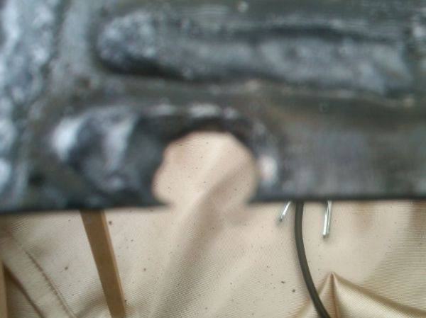

    Then I got retard......was messing with heat and length of hold....whooops Sent from my Verizon Wireless BlackBerry

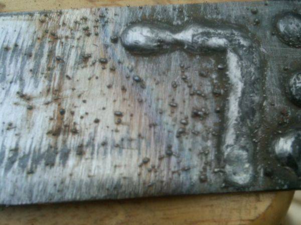

    flux core....
    still need to buy a tank....
    im thinking 40cf tank?
    im not going to weld often....
    but i will be spending some time trying to get a decent bead down in the coming weeks

    Number 3 with a good over lap. try it with the heat up one more setting

    Looks cold meaning you aren't getting enough penetration. Turn up the heat. You may also want to check the polarity of the torch. When you weld w/flux core wire, the polarity is usually reversed.
    These Welding Tips and Tricks should also help.

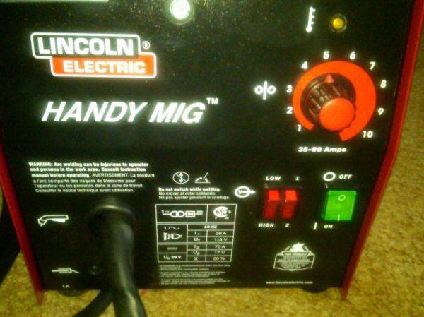

    yes got the polarity correct.....
    not sure how to turn up heat ..:cool:

    Does it have a "POWER" knob like the feed knob?

    No...:mad: I guess you get what u pay for:mad:

    Turn the AMPS up.
    Also, that web site has some great info on setting up the wire feed mechanism.

    The switches...LOW/HIGH...1/2...are your heat or Amperage settings.
