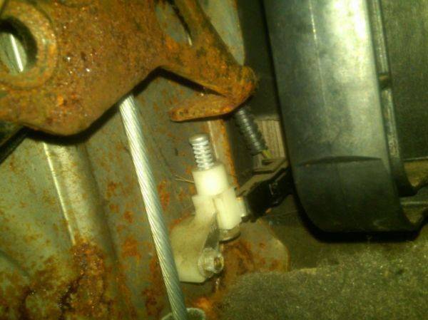

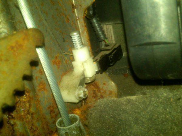

    F.U> GUYZ
    broken mods
    if i press on switch it goes off the light?

    Your pedal isn't returning to the "home" position.

    light just stays on on dashboard..... until i press on switch....
    me going to make switch go bye bye i think.....

    Looks to me like if you can loosen the bolt then move the switch until it makes contact with the metal bracket enough to push the switch in... then tighten the bolt back up.
