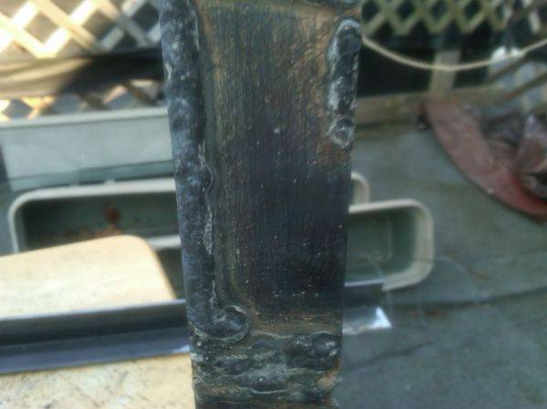

    broken mods
    Help machine does about 10 welds and shuts down on tempature Sent from my Verizon Wireless BlackBerry
  9. Jan 8, 2013 at 12:03 PM
    98tacoma27
    98tacoma27 is going full "SANDWICH" Moderator
    Dec 18, 2008
    #11714
    67,858
    Ben
    Not Beech Creek
    05 Tundra SR5 (+295k AND COUNTING), 2006 F350 King Ranch 6.0L
    Some stuff. Not a lot, just some.
    That means you have over heated it. It's the result of a low duty cycle. SLOW DOWN

  10. Jan 8, 2013 at 12:04 PM
    brutalguyracing
    brutalguyracing BIG DADDY
    Jun 28, 2009
    #19000
    24,052
    F.U> GUYZ
    broken mods
    slow down speed up wth man
    im freaking out over here
    i just ran a 20 amp seperate circuit for this thing....
    i have a 20 amp breaker and 22' of 12/2 to its own outlet....
    it turns out before i was on a 15 am breaker:eek:
    and now it over heats.....
    so do u mean slow down with the amount of welds or slow down while welding
  11. Jan 8, 2013 at 12:10 PM
    98tacoma27
    Dec 18, 2008
    #11714
    67,858
    Ben
    Not Beech Creek
    The amount of welds. The duty cycle on these 120VAC welders is low in comparison to big high dollar units.

  13. Jan 8, 2013 at 12:11 PM
    brutalguyracing
    Jun 28, 2009
    #19000
    24,052
    F.U> GUYZ
    broken mods
    :thumbsup:
    gotcha
    just think i did so many more weld the other day..and no overheat
    now with new breaker 10 welds and temp.....
    oh well
    thank you again kind sir.......
  14. Jan 8, 2013 at 12:12 PM
    brutalguyracing
    Jun 28, 2009
    #19000
    24,052
    F.U> GUYZ
    broken mods
    lincoln 125 volt mig..not sure on model...

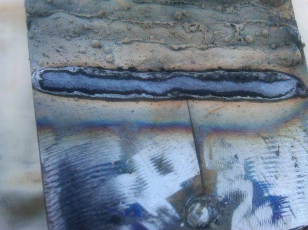

  15. Jan 8, 2013 at 12:18 PM
    brutalguyracing
    Jun 28, 2009
    #19000
    24,052
    F.U> GUYZ
    broken mods
    Woot,woot my best bead yet.... Any tips advise Sent from my Verizon Wireless BlackBerry
  16. Jan 8, 2013 at 12:27 PM
    rctoy
    rctoy It's about to get real!!!
    Feb 13, 2012
    #72789
    6,981
    konstantenos
    Pocatello Idaho
    First gen 4door monster in progress
    TRD super charger, URD fuel mods and 2.1 super grip pully, Headers, 2.5" glass pack, Dana 60 front 4 linked, 14bolt rears on chev 63's, 5.38 gears, ARB locker in the front, PSC full hydraulic steering, 18" SAW 2.5" triple rate coils overs, FOA 2.5 air bumps, B&M launch controls, B&M trans cooler, 4 alpine 6X8 type R's amped, Red led rock lights, CBI front and rear bumpers (my design) CBI sliders, 4 riggid dualys front 2 in the rear, custom track bar, ARB snorkle, warn VR8000 winch, Viair 480c twin compressers..
    make sure you push your welds.. dont drag them looks like flux core rod. i hate the shit.
  17. Jan 8, 2013 at 12:32 PM
    brutalguyracing
    Jun 28, 2009
    #19000
    24,052
    F.U> GUYZ
    broken mods
    i have been doing pulling the welds.....and yes its .35 flux cored wire
    eventually i will hook up the gas....
    so your saying try n push the weld.....
    will do.....
    anyone know where to find some cheap metal to practice on
    dude over here wants $70 for a 3' x 4' sheet of 11 gauge sheet metal

  19. Jan 8, 2013 at 12:37 PM
    rockgecko03
    rockgecko03 Well-Known Member
    Feb 25, 2010
    #32106
    1,845
    Ben
    Rockwall, TX
    1999 Tacoma - Perpetual Project
    I was always taught to drag with flux core. If you go the other direction, you end up throwing slag all over the area you're about to weld and you can't control your arc as it will start jumping all over the place. In the end it will look like a big booger if you push the puddle with flux.
  20. Jan 8, 2013 at 12:39 PM
    brutalguyracing
    Jun 28, 2009
    #19000
    24,052
    F.U> GUYZ
    broken mods
    :notsure::goingcrazy:
    me dont know dude in video i watched told me to pull
