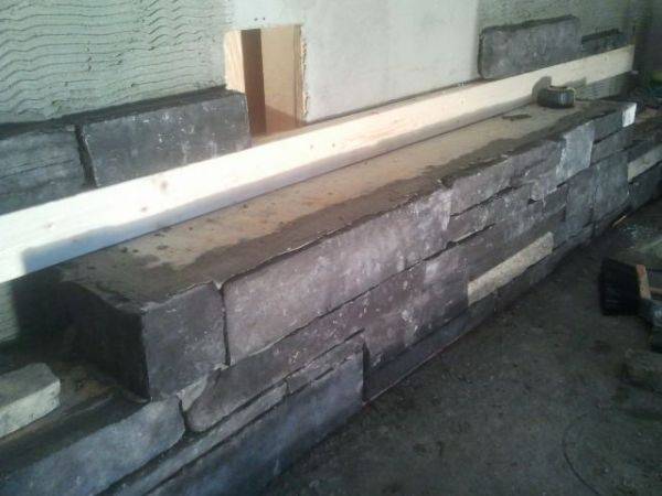

    6" natural stone veneer ?

    Cultured stone
