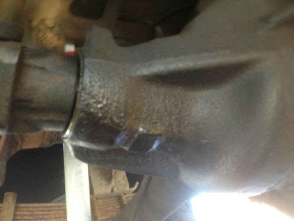

    This is on my jeep. Any idea what might be happening here??

    Hahaha amen! I'd never have a jeep as a daily driver! I'm just keepin the yota a street queen and using the jeep as a beater/trail rig.
    Maybe a rear pinion seal leak?

    That would be my first guess.

    Actually just did this job on a buddys cherokee...really easy

    Sweet! Hopefully that's it. Any way to tell that's what it is for sure? And how long of a job?

    Its that seal for sure. .put it in Neutral and go underneath. .push up and down on driveshaft..if it moves then the bearing is bad and thats why the seals gone...if not then its just worn...took me an hour..I have a seal puller and air tools....and a lift
    Heres what his looked like

    Awesome! Thanks man! I'll try that tomorrow. And I'll probably have a shop do the work. Also, it wouldn't be the carrier bearing, would it?
