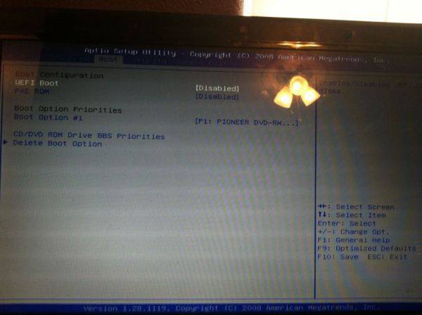

    You BIOS isn't seeing the HD, therefor wont boot to it, either it isn't spinning or the HD controller on the motherboard is cooked, either way with it being an Asus, get your data off the drive and go buy an HP.

    I hate to be the one to tell you, but if you didn't mess with the bios to begin with, then you either have a fried HDD or MOBO.
    Your best option is to take it with you and find a friend who has a laptop, pop it in their laptop and if you get the same problem, I hope you had the drive backed up.

    Well that's some terrible freakin news. Is there any way to fix either of those issues? If this were a best case scenario which one of those 2 issues the better to have and like I said, fixable?

    So take out my hd and put it in a friends laptop and if the same thing happens the HD is fucked huh? Wonderful.

    If your hard drive is toast, replace it. May not be so easy if it's the motherboard though, considering the fact that it's a laptop.

    Yes

    Get the HD, put it in an external drive case made for 2.5 drives with USB connection. Hook it to another computer and see if it works and/or get your info off it onto another external drive. Done.
