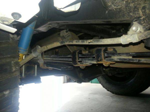

    225lbs in the bed and my leafs are flat. Is that normal?

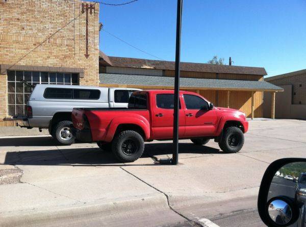

    Williams. AZ. Anyone?

    The leafs are fairly flat to begin with

    Guess I just never really looked, I dont haul anything in my bed normally but I have my bumper and IFS skid in there right now

    hard to see in my phone. is that a 3 or 4 leaf pack? if three, call your dealer and have them order the tsb parts and schedule a time to install.

    Tis 3+overload.

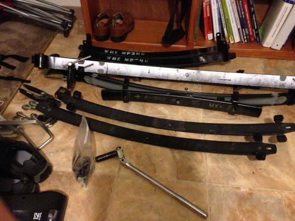

    Doing work in the kitchen/dining area?:cool:

    This, and I'm installing a Wheelers AAL tomorrow anyways

    AAL should last 2-3 years depending on how hard you wheel it....
    wheel hard and within about a year the AAL will be flat....or at least mine is after that long with steel rear bumper and tire carrier

    Look into OMD chevy leaf to help give real life back to your pack. I've got the wheelers 3 leaf and wasn't completely happy. I got a chevy leaf and swapped out the 2nd from top Toyota leaf.
