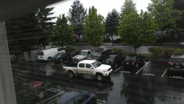

    Creeper peeping my truck. GTFO with your shocker sticker and So-Cal sticker in the back window.
