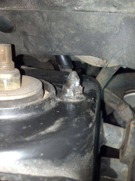

    You need impact. That should be np. Looks brand new. My bolts look much worse.....dam salt

    Thinking about using dremal and cutting the motherfucker....since I'm not keeping the bolt anyway

    That will work. Just don't cut all the way so you no hit tower then smack it off with bfh.
    U using a wrench?

    box wrench
    pulled and pulled and slam then this. fuck
    gonna cut it the thin way ( "d" with the line being the cut)
    then chisel that bitch off
    wanna finish this shit tonight

    Take the nut off the threaded thingy

    x2 to big ole vise grip and heat. Get the vise good and tight... Might try banging on the vice with a hammer to get the impact force effect.

    Need socket and breaker bar.
    Vice grips blow imo but I do have 2 sets in my truck in case a brake like or similar needs pinching.

    Couldn't fit a socket on the back one, fenders arch in in the back
    Dremel almost worked...ran out of daylight

    Little fucker...didn't cut into the shock tower, Thats just glare from the flash
