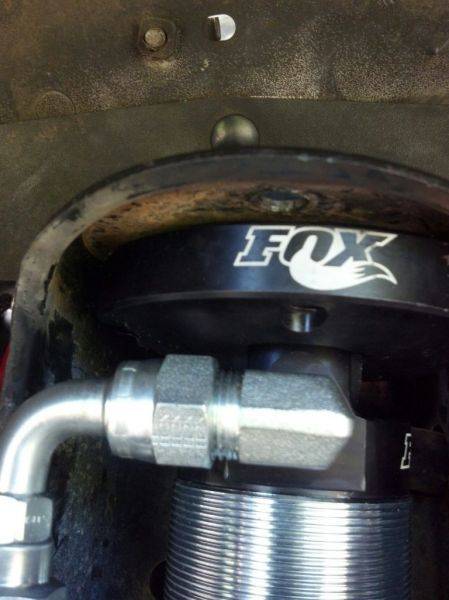

    Rotate the fitting?

    Rotate fitting over uca. Take resi over top of uca to your mount point. They don't necessarily need go under them. Over the top would give you more play

    I was under the impression to stay the fuck away from the fittings unless you're taking the shock apart to be rebuilt.... Am I wrong?

    Looks like you need a 90' fitting? Either that or can you swap them for better reach?

    Is that fitting facing the front?
    http://www.ridefox.com/dl/truck/manuals/605-01-062-co-toyota-web.pdf
    It says make sure hose/fitting is in front. If so, then... dunno. Maybe you can't use the new UCAs?

    The 90* in the shock body you want to be cautious of as it has thread sealer on it. The fitting that has the hose attached does not. See if you can rotate the 90* fitting that has hose directly attached inwards towards the coil body.

    Here's what it's supposed to look like:
    Check that the reservoir is facing forward.

    I think the fitting is facing backward. Not forward (which is the "bigger" side of the UCA).

    Swap those shocks to the other side and see if you gain clearance?

    resi is facing forward... unless I have this upside down which I hope is impossible

    Disagree. That looks like the drive's side coilover to me, not passenger side.
