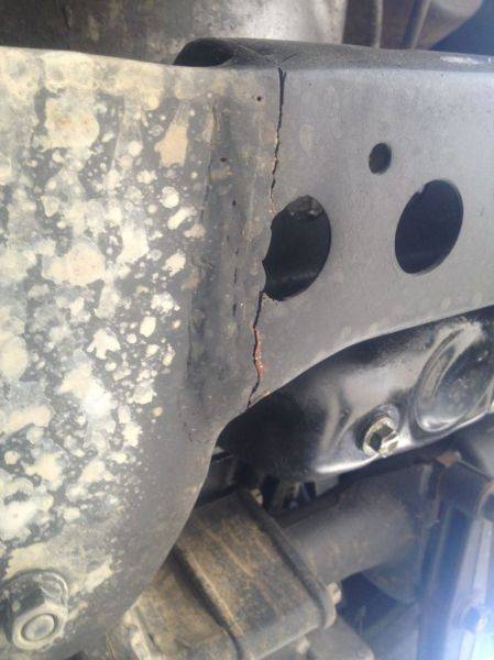

    Found this crack in the frame of my cousins truck the other day. It's a 05+ tacoma with a 3" lift. It appears it is in a non factory weld, anyone know why this weld might be here?

    Crossmember cut out for DB lift and then welded back in? :notsure:

    X2 and looks like the welder didnt get CJP on that weld.

    This might be it ^
    Whats CJP? :confused:

    Complete joint penetration

    It is Complete Joint Penetration meaning the welder fully heated both base metals in order for them to have coalescence with each other.
