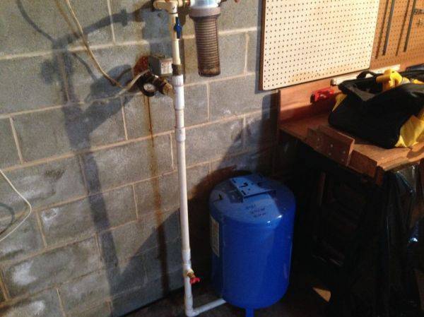

    That's your pressure switch. How is the expansion tank? Some time the bladder goes bad it won't hold pressure.

    The gauge is for information only. The other device with the wire is a pressure switch to turn your pump on & off according to the set pressures inside. What your problem most likely is, is the pre-charge pressure in your pressure tank. It should have an air fitting on it where you can check/adjust it. You'd have to drain all the pressure off the system first to check. Google it, or call a pro if you aren't sure how to proceed.

    check exp tank...like scott said......
    do u fell the pressure change? or just by looking at gauge ?

    Wider view. Pressure tank was practically new when I bought the house. Markings on tanks say 4/7/09, set to 38psi, 40-60psi. Never feel the pressure change happen. One day it's strong, next day or later in the day weak. Back and forth.
