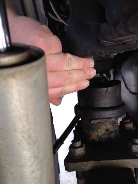

    why the up travel killer block?
  5. Apr 21, 2014 at 10:08 AM
    jberry813
    Jan 21, 2011
    #49636
    28,479
    Jason
    Lake Tahoe
    2012 DCSB Sport
    ...too much shit to list.
    Because shackle flip.

    it looks like the remnants of a wheelers superbump that had the top ripped off

    So he's worried about inverting or rubbing?
    Oh I know what it is. Just never saw a need for the blocking. It kills up travel and was not needed on my truck.

    because it's shorter than the wheeler mount...bump was cut to allow full compression with the shock

    so i don't have my shock be my bump stop

    Well that's one way to do it :D
    Seems backwards though.....I'd prefer to keep the bump longer and remove the steel blocking if possible :notsure:

    That would be a whole different bump stop though. SuperBumps are not modular like those other stackable ones. I assume he got the SuperBumps before getting the shackle flip and needing longer bumps/less uptravel.

    the mount was made based on original measurements...but real life compression still limited the uptravel...so i took a handsaw to it in moab and solved that :D
    so i'm looking at options now to give me more bump and less mount...but i'll have to get a new top plate or cut this mount off..

    Ever considered inverting them?

    yup...may be my best option at this point...get a longer bump and mount up top then get a fresh plate for it to strike
