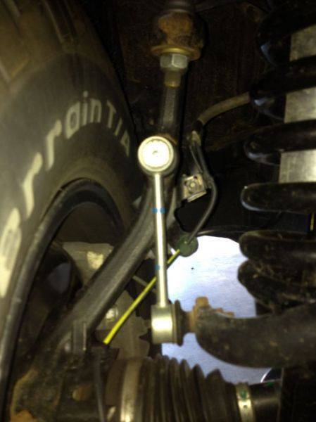

    Question: I'm trying to take the swaybar off, and I've loosened the bolt on the link, but it got near the end and is now just spinning with the bolt. How do I take the nut off the link bolt?
    Didn't want to start a new thread and can't find this answer.

    isn't there a Allen head on the other side?
    :notsure: i took mine off years ago

    This is the other side...just a little bevel on the link

    There should be a hex/allen hole in the bolt shank. You need a box wrench and the allen inside it. Might be packed full with road dirt/mud.

    Found a thread that explained this just as you posted. Thanks! :thumbsup:
