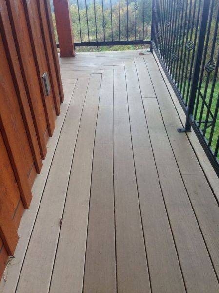

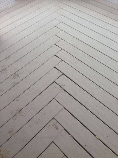

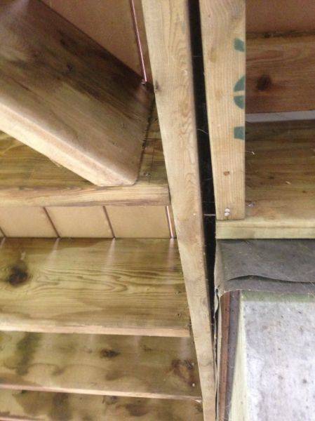

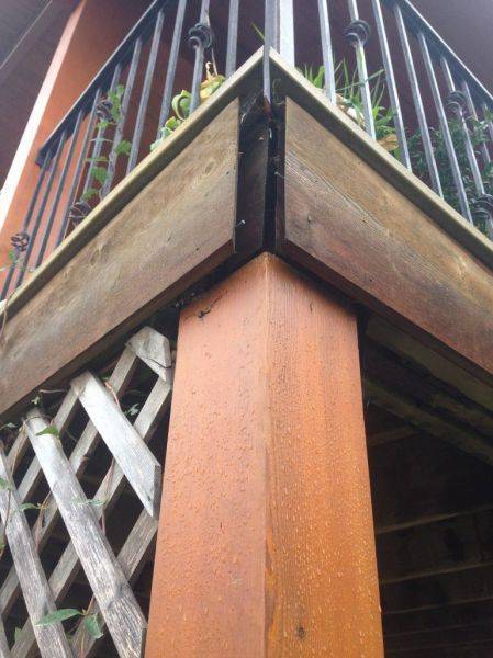

    what happened there?

    ahhhhhhhhh, I am trying to think of the other type of decking that people seem to have this issue with. I think its treks

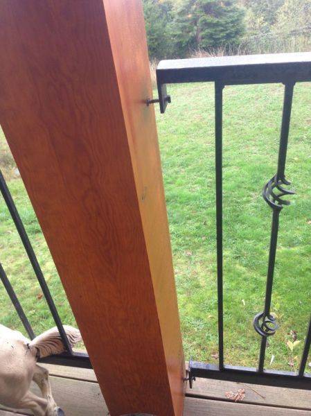

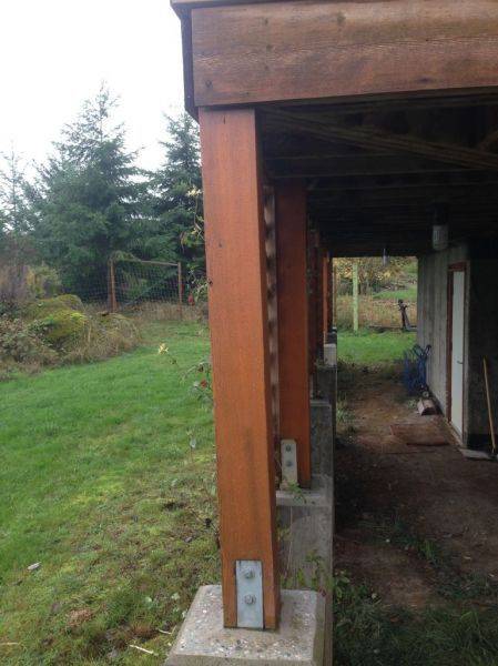

    After looking at those pics, that's some massive settling. Sinkhole under the footing(s)? ?

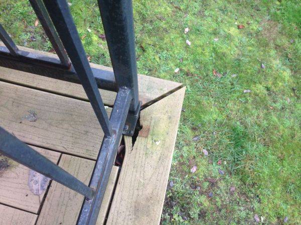

    No , the composite decking has grown in length so much it is pushing the deck framing off of the building
