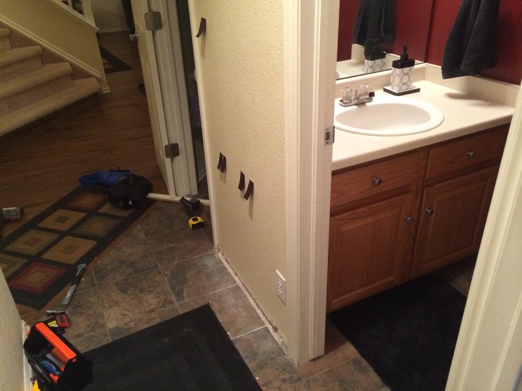

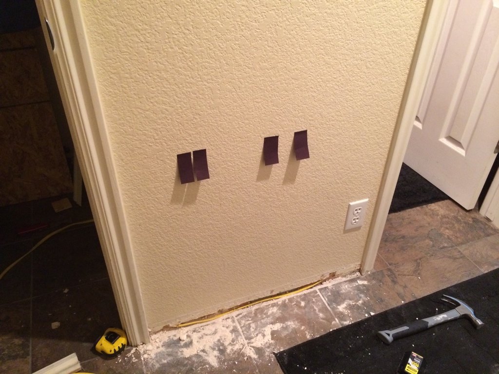

    How tall will the baseboard be when installed ?

    oh , picture tall
    I was going to suggest you could cut a slot out of the drywall slightly lower than the top of the base and drill through the studs at the bottoms in the centre of the stud , run the wire and install the base , but doesn't look tall enough to pull that off
    What's on the other side of the wall ?

    Is there an open basement under the wall? If there is you can drill a hole from the basement inside the wall and run the wire up to the switch location.

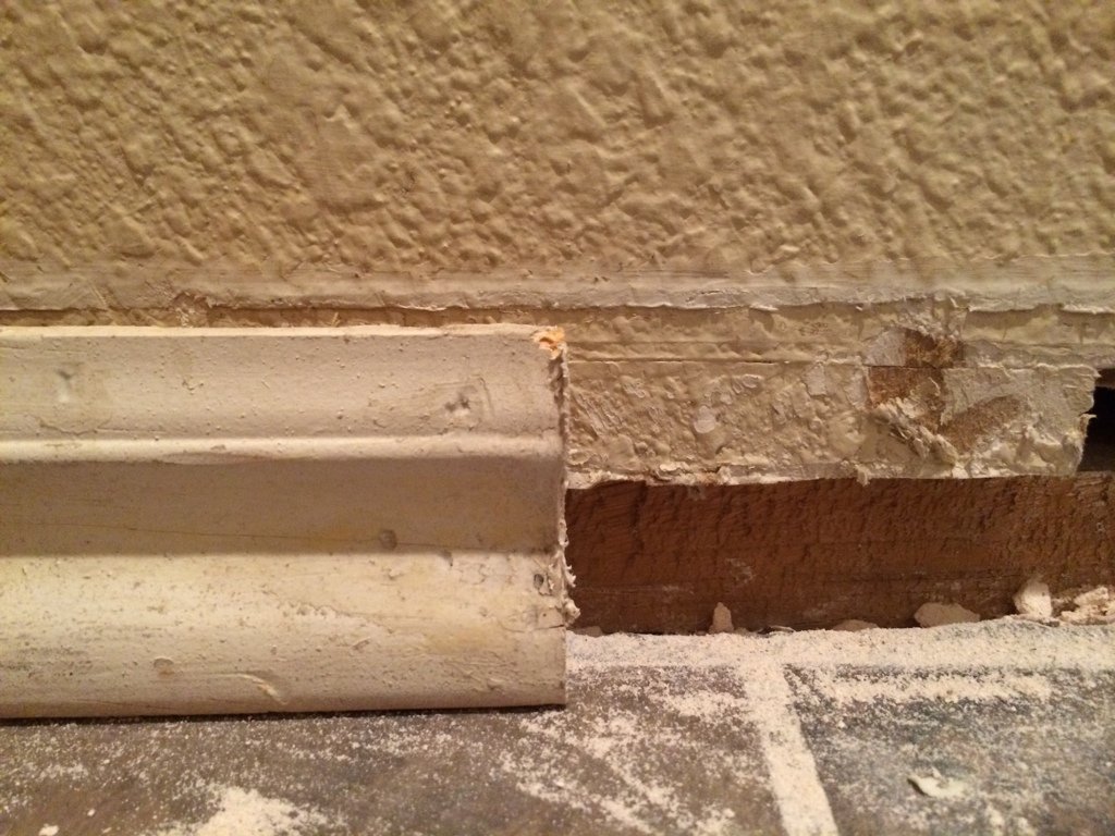

    Basement below. Maybe option to drill through sole plate if I can figure out center of wall.

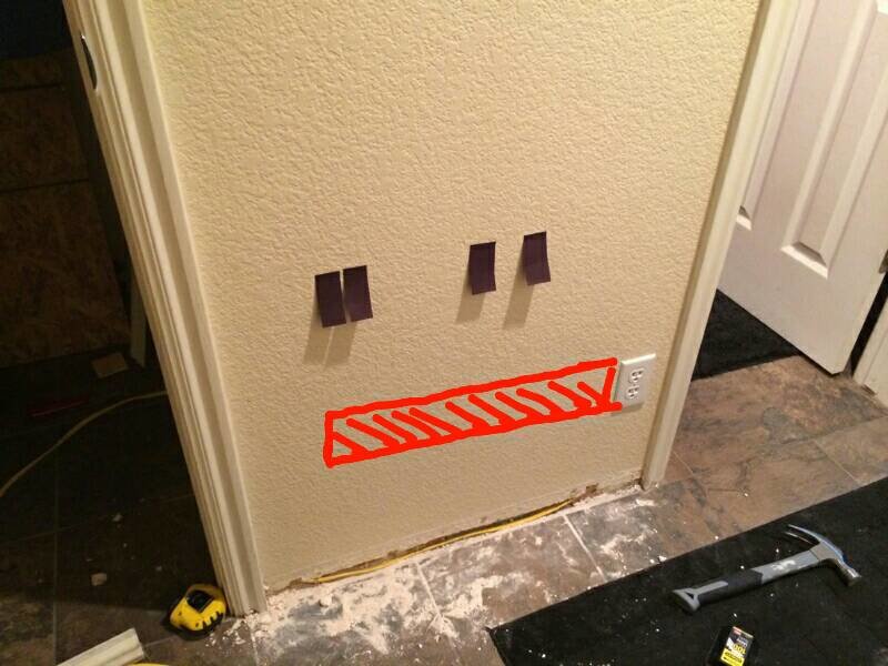

    Here was thought

    No bueno , only way I would ever even consider that as a last resort would be with BX

    There is two protection plates on the sole plate of the wall so either wiring or plumbing or both is going down to the basement shouldn't be too hard to figure out

    Ok not going this route

    Cut wall and patch. 20min.of extra work

    I can understand not wanting to try to match the textured surface but unless going up from the basement is feasible this is pretty much the answer

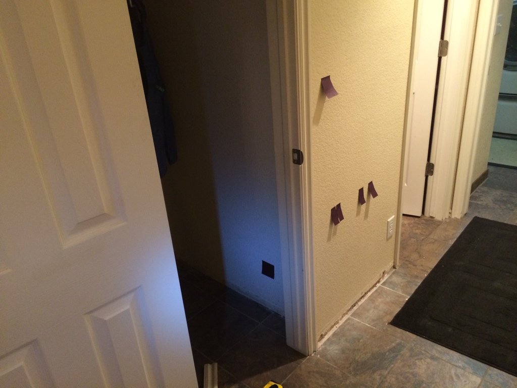

    whats on the other side of the wall? would the patches be easier to hide/less noticable if you cut into the opposite face of the wall?

    Adding outlet to closet on back of wall. Other side of closet wall is bathroom sink cabinet.
