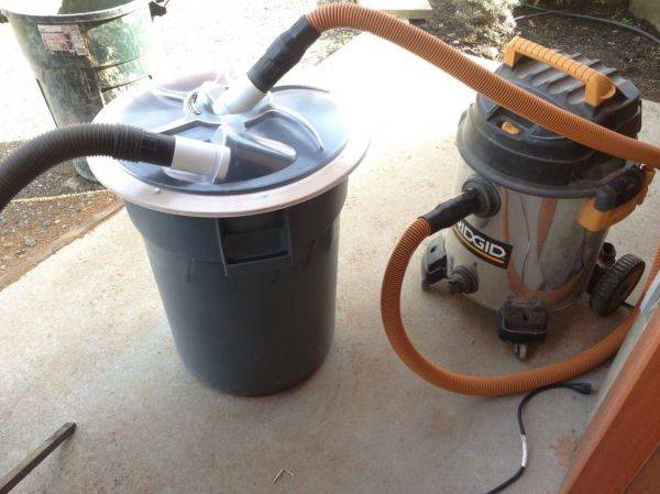

    I would really prefer a smaller can , but these are very rigid walled so a may need to go this route and maybe cut it down
  3. Feb 16, 2015 at 12:30 PM
    OZ-T
    OZ-T I hate my neighbour
    Dec 15, 2009
    #27584
    50,587
    Peter North
    British Columbia
    Rings on the outside won't keep it from collapsing in
  4. Feb 16, 2015 at 12:39 PM
    OZ-T
    Dec 15, 2009
    #27584
    50,587
    Peter North
    British Columbia
    The can collapes inside of it's outside diameter . I already drilled a relief hole as per the instructions in the lid .
  5. Feb 16, 2015 at 12:43 PM
    OZ-T
    Dec 15, 2009
    #27584
    50,587
    Peter North
    British Columbia
    That's not the answer . The can is not rigid enough . Drilling more holes will only compromise the cyclone effect

    Success , kinda

    What was the solution? Does the top stay on due to the suction alone?

    Yeah with the vacuum running you can't lift the lid at all

    two 2x4's forming a X to increase rigidity and cyclonic effect.
