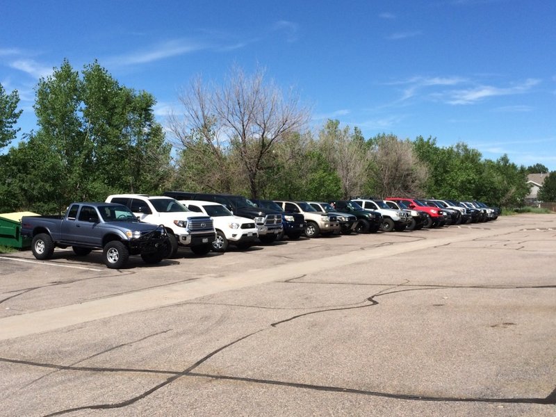

    Good turnout for our meet! 26 trucks!

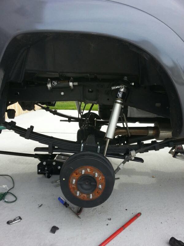

    Where have you been all my life? Lol thank you!!!!!
    Yep, makes an ass outta you and me. :cool: I think it's Xbox time. I can ride the moto to work tomorrow

    Wait what on backwards? The aal is mounted with the longer end towards the rear. The overload is exactly the way it was before I broke it down...
    That bracket has to be there to mount the brake line correct?

    Looked like you had the aal backwards. There is no interference between the overload and the aal pack. I'll post up an old pic here... hold on.

    In this pic you can see where all the clamps end up when properly installed. Same wheelers pack and 4 leaf OEM pack as what you are working with...if it doesn't land like that you might not have the right AAL...

    I see what your saying. This is not good news. I sent a message this am to @YotaDan I hope I didn't wait a month for the wrong part.....

    So now I got a truck, that I can't drive, that might have the wrong part on it, that I've cut the center pin per instructions, the company is on the other side of the country which means at least a 8-10 day turn around if not more.....probably the worst install I've ever had to deal with.
