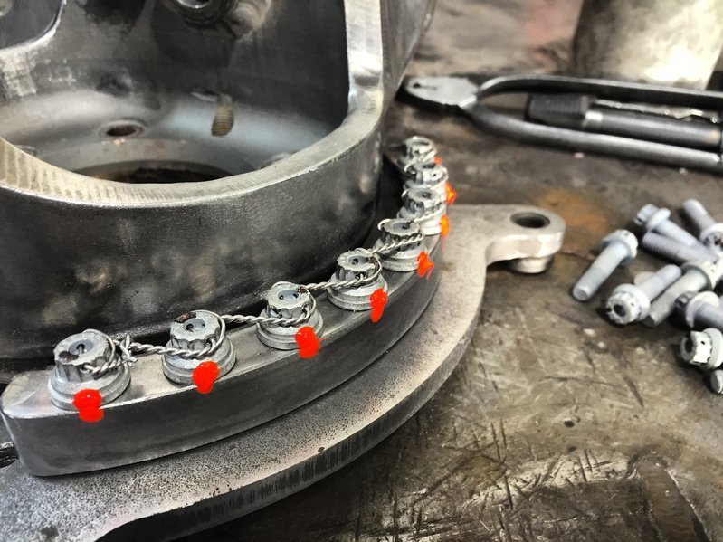

    Nice, like the lockwire and torque-stripe. What are we looking at?

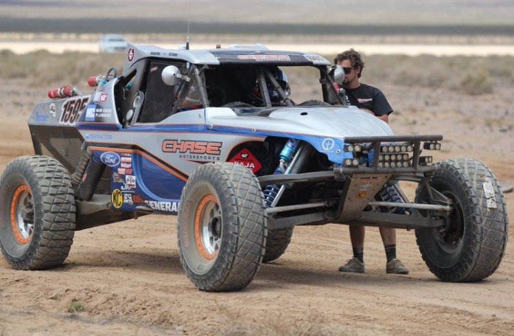

    Front caliper mount on an upright for a Porter/ES Motorsports Class 1/1500 car. This car to be exact.

    Very cool. So the torque-stripe is for anti-tamper verification?

    Yes, as well as a visual indication that those bolts have been torqued to spec. It's very helpful when a car is going back together to be able to glance at hardware for the bright orange torque check and know that it has been torqued to spec, especially if you have more than one person working on the same car. It's also to make post-testing and post-qualifying car checks easier/quicker, if the torque check isn't broken, you know that the hardware hasn't moved or loosened.

    image.jpg Follow up to my previous post. Both caliper mounts finalized.
