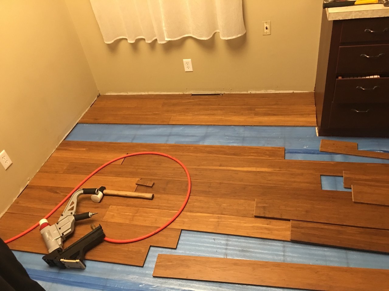

    You nailing the groove side ?

    Yes. Working backwards from working backwards.

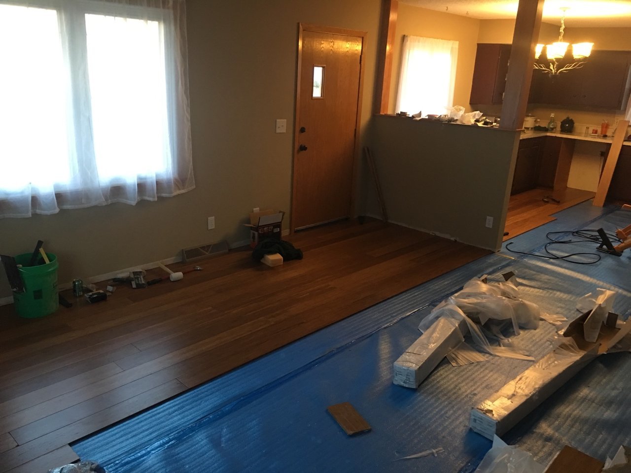

    What is going on here? Isn't this laminate flooring? Please explain. I've never installed in this manner.

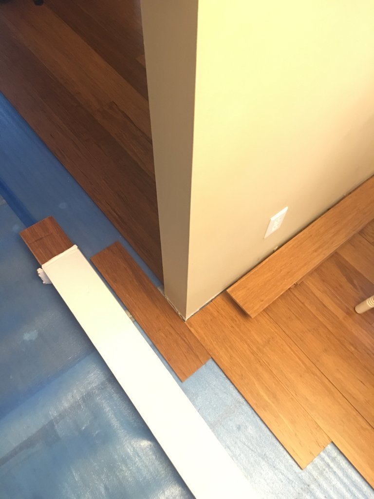

    Bamboo. I hired a flooring guy to lay it, but it turned out he's a hack so I had to tear out what he did and redo it.
    Here was the issue. The boards didn't line up at the end of the wall.

    I see now. Thanks.
    I would have ran the floor opposite of what the hack did.

    90 degrees? Then it would be parallel with the floor joists. It's a 40' long span.

    Oye, vey, you did have some issues to get past.
    Thanks for taking time to educate me. Looking forward to the completion pics.

    don't lay the boards in the kitchen at the same time as the other side of that half wall.... do it on one side, then however it crosses over the half wall at the end back track to the kitchen cabinets. cant expect the face of your kitchen counter tops to be the perfect depth from the front of the house to match up with a whole number of boards.
    make sense?
