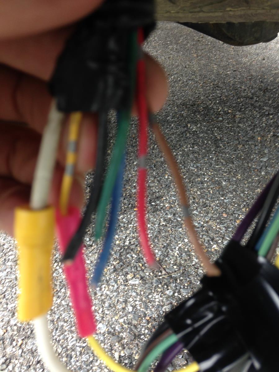

    Alright, i dun goofed. i was replacing my broken trailer hitch with a new one from Amazon, thought all the wiring colors matched as they did on the diagram included on the package and the one i thought was for my truck, realized to late that i was looking at a diagram for a Nissan frontier :frusty:
    My truck is a 2007 DCLB V6 SR5 with tow package, heres a pic of the wiring after i cut the broken plug off, dont mind the two already connected wires, i had two connected when i realized i screwed up
    In case thats too blurry, i have:
    1 Solid white wire,
    1 Yellow wire with double silver stripes
    1 solid black wire
    1 solid green wire
    1 solid blue wire
    1 red wire with a single silver stripe
    1 brown wire with a single silver stripe
    Can somone help me out and tell me what goes to what? i tried to figure it out with my multimeter but am getting a few funky readings, probably since theres no plug

    Hint: a digital multimeter is the worst tool to figure out what's, what.
    Ghost voltage reading makes the job suck with a digital VOM.

    Going by memory.
    Blue-brake wire not lights
    Brown-running lights
    Black-auxilarry or battery charge
    Red-turnsignal/ brake light
    Greeb- turn signal/brake light.

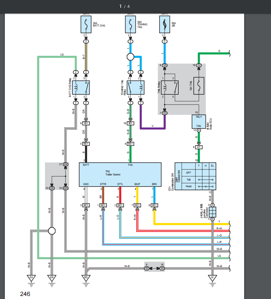

    Remembered i had a 2006 FSM on my drive, does this look about right for the wiring?
    so according to this, if i read it right,
    white=ground
    brown=right turn signal
    red=left turn signal
    yellow=backup lights
    blue=electric brake output
    green=tail light illum
    black=acessory power
    seem right?
