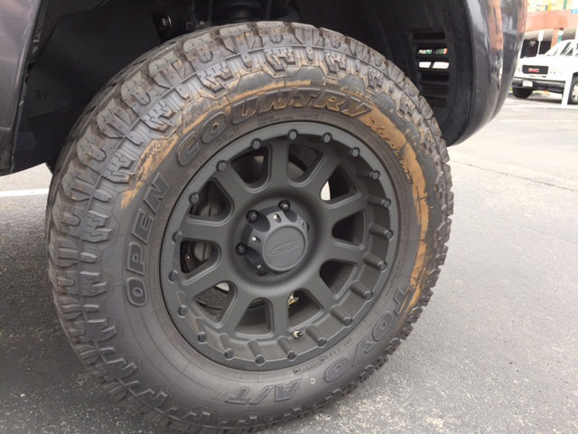

    Purely cosmetic, I think, but what the hell? Got these fresh from the factory two months ago, barellllly rubbed up against a curb today and this happens. So strange. Must be the sidewall material?

    No complaints, really, just wondering why it got so discolored. Even when I grazed it with the side of my shoe, the same thing happened. Just weird, that's all.

    There was just a thread about this. Your bumping the curb accelerated it. It's called tire blooming...
    https://www.drbeasleys.com/blog/2013/07/11/why-are-my-tires-brown/

    Just get some cleaner...Wesleys Bleach White, ect....then get some protectant on them and itll keep it at bay. Aerospace 303 sprayed on is nice. Not too blingy.

    Thanks for the info. Never experienced tire bloom before. :cheers:
