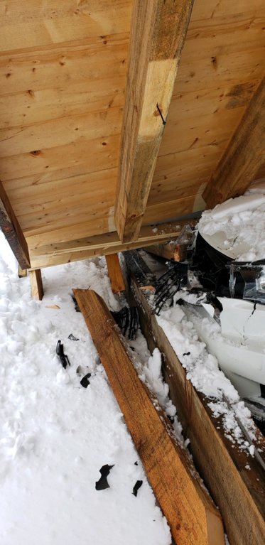

    I wasnt there, they said it sounded like a big ol tree fell on the house

    The collar ties are in the top third of the rafter and look to be added to the underside of the timber rafters , hard to see what connection is there but there is no ridge beam and if there is no other crossing beams the structure is relying on those short collar ties to resist the beams from thrusting outward under roof loading

    One fucking timbertite it looks like. I'd say that's not a whole lot of surface area holding those on.

    Yup. Just noticed that picture. That'll do it.

    Bolts have probably torn through the grain on all the ends of the collar ties

    Was the a permit and inspections on this building ?

    That, I honestly don't know. I know permits were pulled and I assume inspections were done. But I guess they'll get that all hammered out in the following days.

    They would have been better off to put plates on the outside of the crossbeam not those single bolts...The beams look strong enough just the attachment looks weak

    I'm surprised also. I see the plates a lot with modern timber framing. Or at least a good mortise and tenon like the old days
