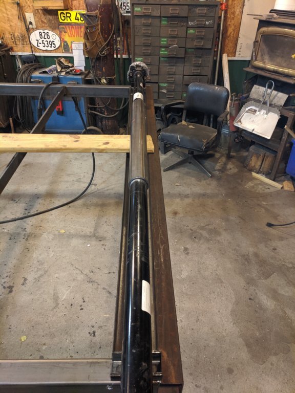

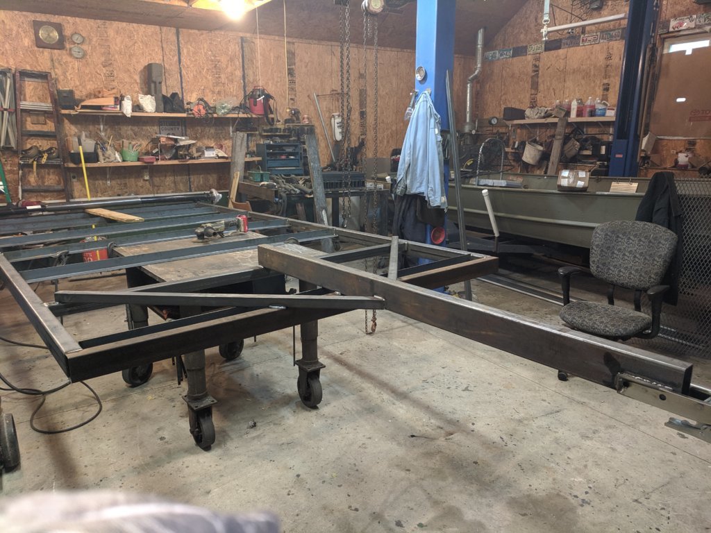

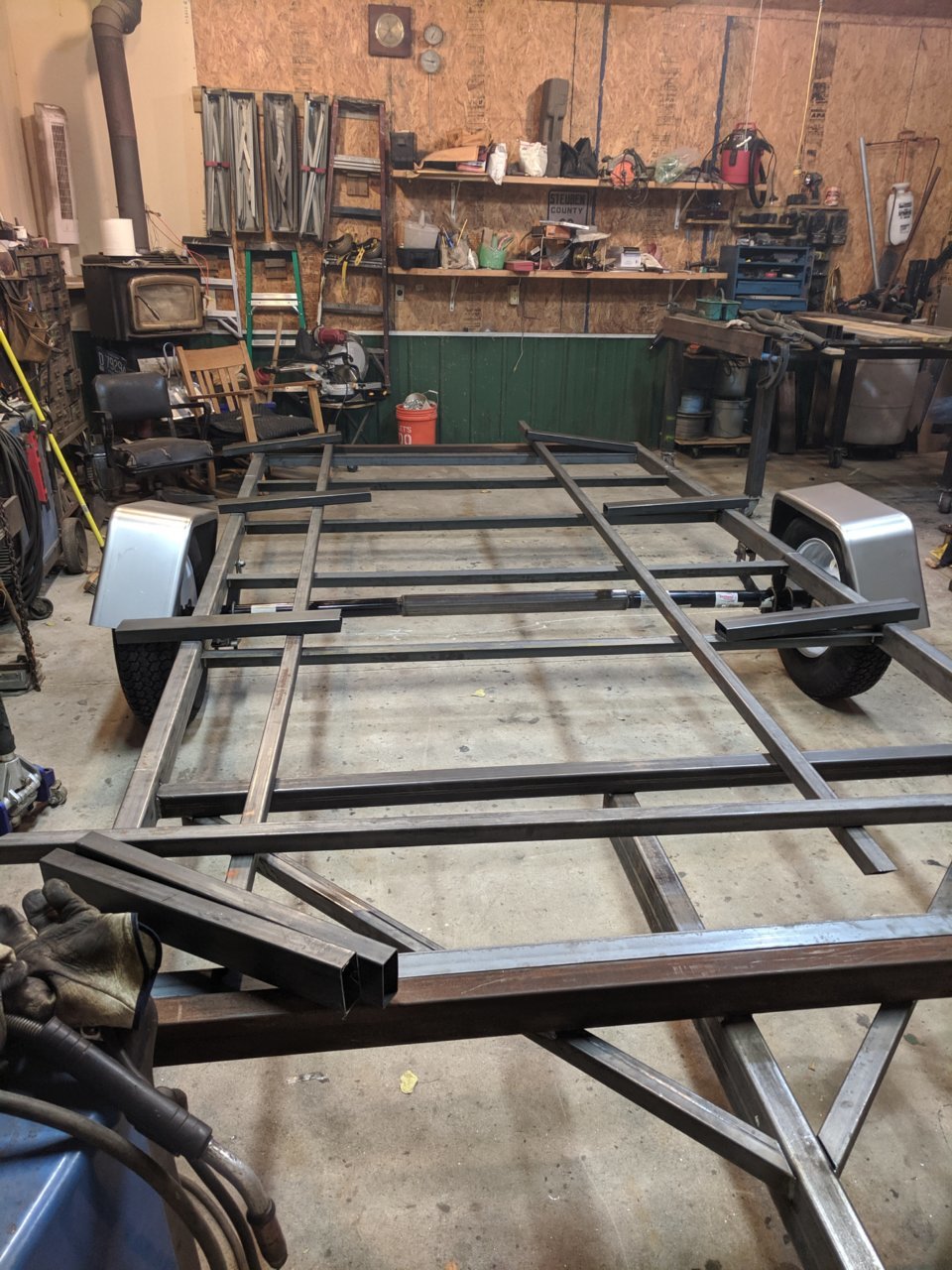

    Reserected from the dead.
    That's it for tonight. Good progress for 5 hrs of welding.

    What do you plan on carrying with that (weight)?

    3k capacity.
    I don't know, it's not mine.

    You're not worried w/3K lbs, that long of a tongue & the way the tongue is attached to the frame?

    Not at all. I've built over 300 of this style. Zero failures.

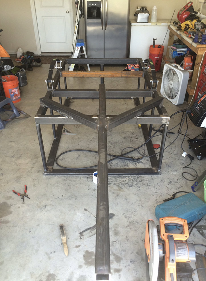

    I guess I overbuild. This is a 4’x6’ with a ~4’ tongue off road trailer. 1/4” 2x2 sq. tubing for tongue and tongue braces. The tongue is so long because I wanted to match my truck wheelbase so it tracked perfectly behind my truck off road.
