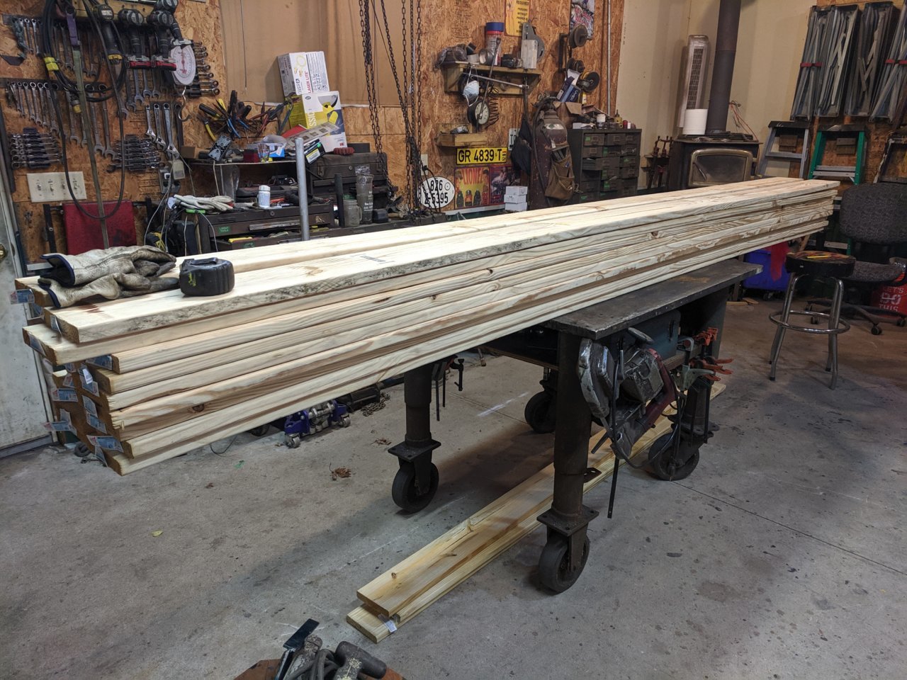

    Stack o'IMG_20191109_121028.jpg lumber

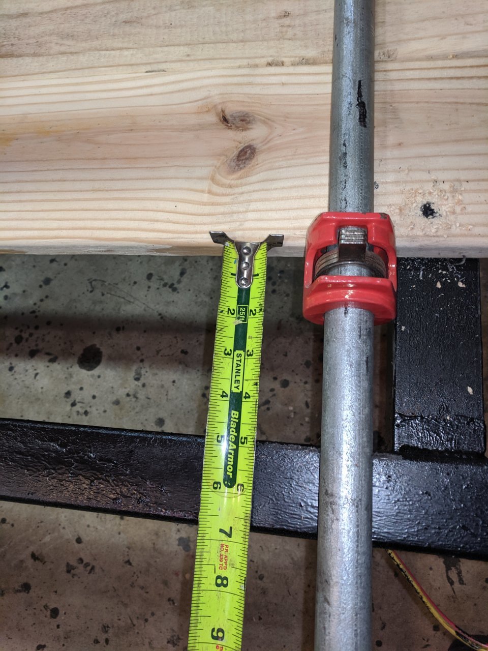

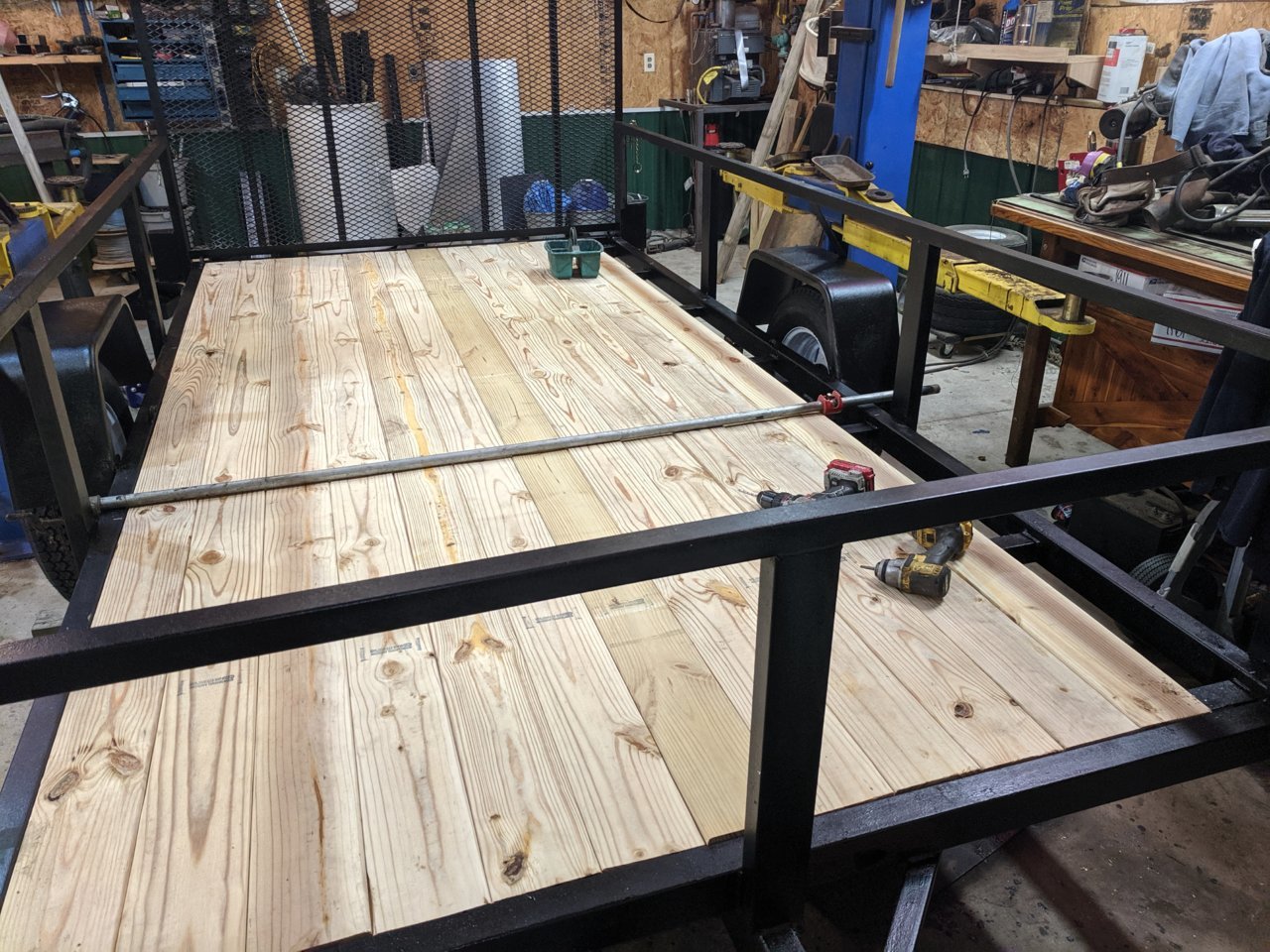

    Last floor board space. Checking both ends and middle are the same width. Using a bar clamp to draw the boards snug.IMG_20191109_124843.jpg

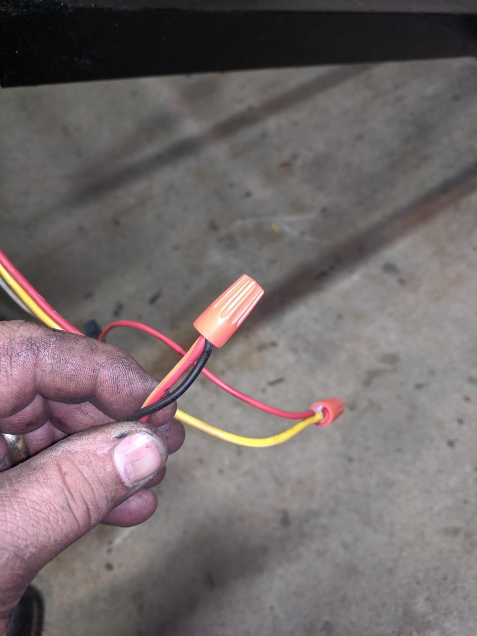

    IMG_20191109_134500.jpg no judging. The wire nuts work the best.

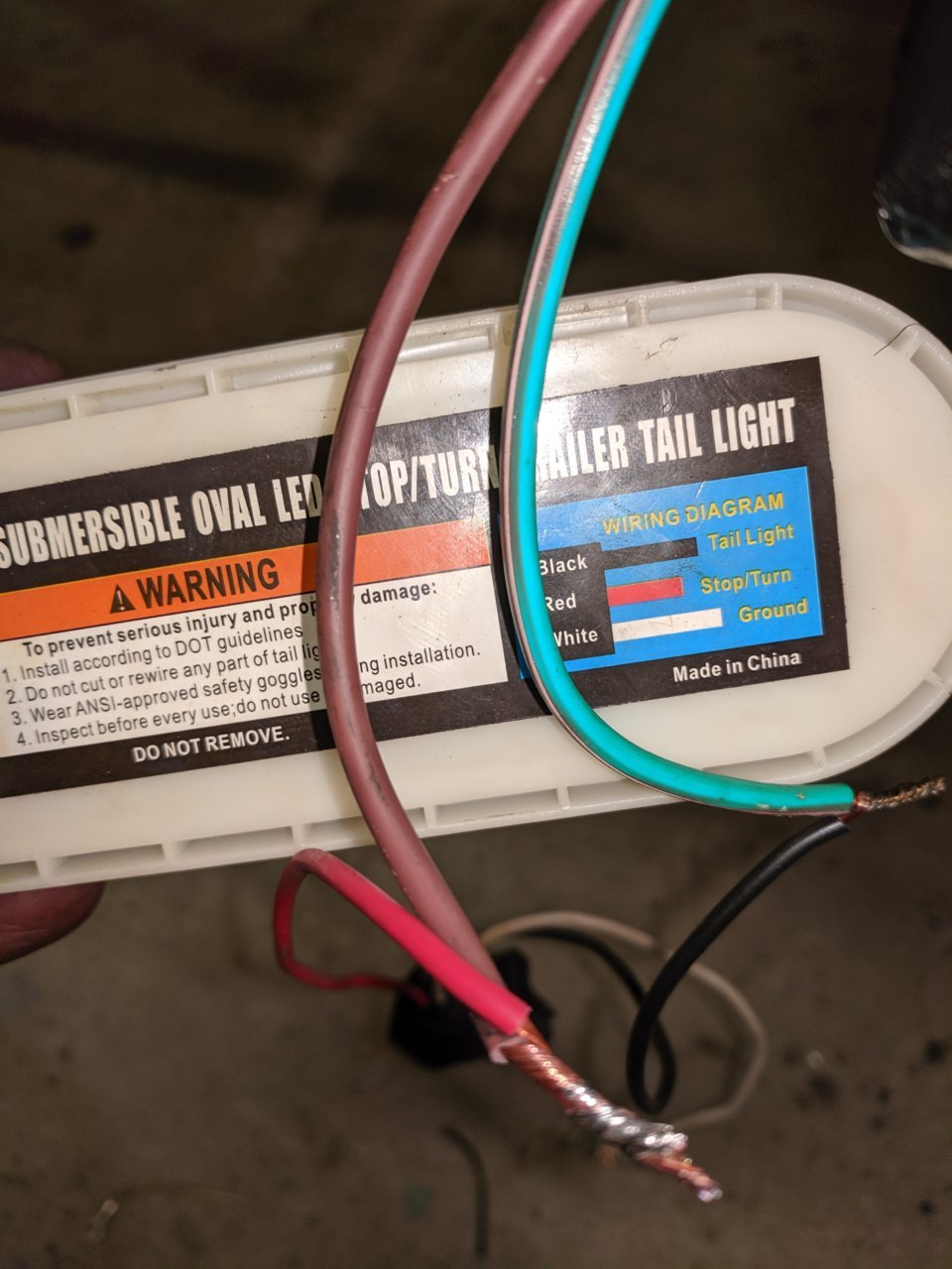

    You would think the peeps making harnesses and the peeps making lights would work off the same page...IMG_20191109_135304.jpg
