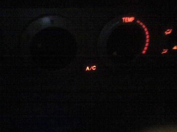

    Fuse or what?

    there should be a small bulb that lights that side...pop out the A/C controls and look st the top of the controls on the back. i think it's a white backing, IIRC. comes out w/ a simple flat head i believe. check and see if that bich is blown

    thanks ill pop it out and see

    since i'm at work and have nothing better to do, i went out there and did some quick testing. i was wrong in a couple places....mine were brown backed tiny bulbs and there were 2. i removed the one on that side and it looked exactly like what u pictured. i'd check for it's tight connection first, then see if it's blown. probably blown
