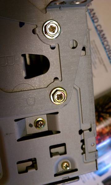

    Installed! Thanks Lady!

    should only be one blue (remote) wire.

    don't use power antenna wire...(blue with stripe?)
    the other blue should be remote.
    three things turn on amp. Blue remote, ground, and power.

    Blue from deck with no label

    get the blue wire that's not for the power antenna to the amp :cool:
    run ground as close to amp as you can....sand paint to make good metal contact.

    Use a socket instead.

    it's a hex head too :cool: or just man up and push harder on the screw driver :laughing:
