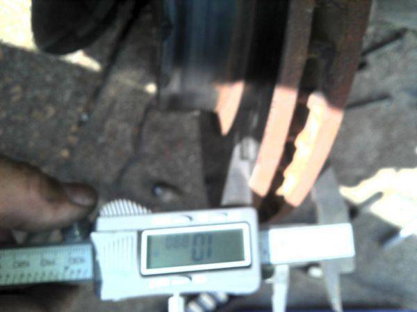

    broken mods

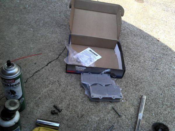

    anyone know where i can get calipers...one of my pistons is siezed up...and no auto parts can get them for me here fml one guy can get them in a week for @239 a piece

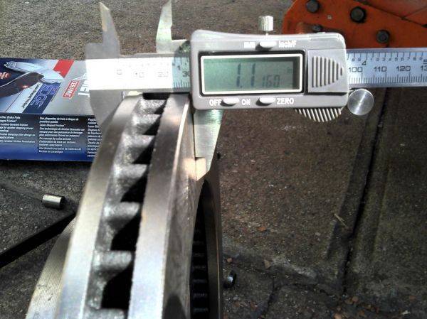

    Old ones look like they're still in spec. I take it they're warped?

    Minimum thickness should be 1.024" (26mm)

    any advise on the caliper spec..

    .039-.0453 (1mm- 11.5mm)
