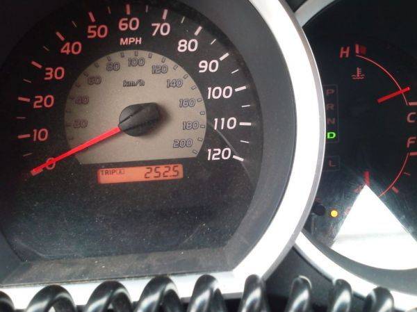

    Worst mileage ive got. Light just came on with only going 252 miles.

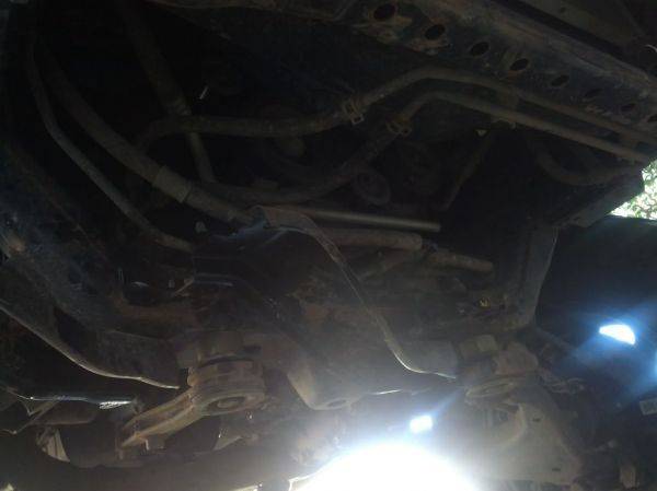

    Hey, figured this was the easiest place to get an answer, whats the trick to getting the swaybar out... I have it all disconnected.... skid plate out... I have not removed the supports to the crossmember. From what I understood you can get it out without... but I'm not seeing the trick.... not enough room.... anyone? Wheels are still on.

    gotta remove the bolts to the crossmember. then it's a twisting game to get it out.

    takes alot of finagiling , wheels need to be off

    non repairable afterwards but simple and effective would make quick work without removing the wheels

    Yeah, its free... just can't get enough room. Guess I'll be busting the lugs loose.

    wait wiat... the bolts to the cross member, the ones that hold the longitudinal support brackets between the core support and cross member? I mean, hell if I took those out it would be pie... but I don't want to bust them loose, plus I don't have a 17mm 1/2 drive which would be required to bust them loose with breaker bar.

    nah...the bolts that hold the bushing hangers to the crossmember...thought that's what you were talking about. if those are removed too, then you should be able to remove it. cant remember the last time i removed mine if the wheels were off or not. would definitely make it easier.

    Got it. Neighbor showed up...had 17mm 1/2". :)
