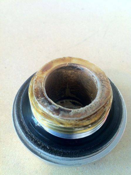

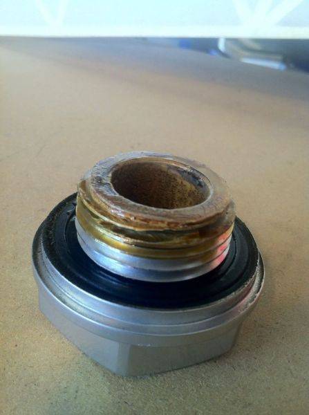

    Oil cap: Is this normal?

    yes. Mine leaves a yellow residue also. I heard it's from not letting the engine warm up to operating temps before turning it off. Like driving short distances.

    What brand of oil are you running?

    you really need to do more frequent oil changes if your going to do a good deal of short trips in the winter. yours is the worst I have seen. that froth is water in your oil. if your changing it every 5k I would go 3k or 4k... and stop doing short trips if you can.
    some moisture and froth is normal but your is very bad.

    That looks like Penzfoil after 2k..

    my Mobil 1 looks like that when I treat my truck like poop and do oil changes past 5k with tons of short trips.
