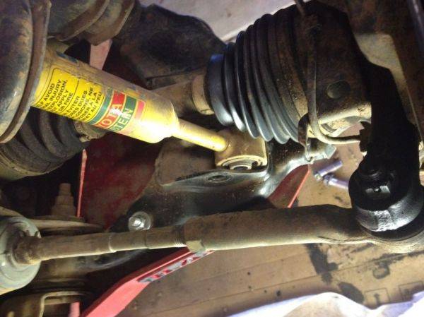

    How do I get the cv out of the way? I can't get this shock out.

    Swing LCA out of the way, should be able to remove whole assembly

    I undid two 19mm bolts under the lower ball joint and I can push the LCA down but it's difficult and doesn't want to stay. Feels like something is pushing it back up. I dont know what it is though.

    Your alignment cams are seized in the bushings

    did you loosen alignment cam bolts that bolt LCA to the frame?

    You don't! Remove uca from spindle, and jiggy! It'll come out!
