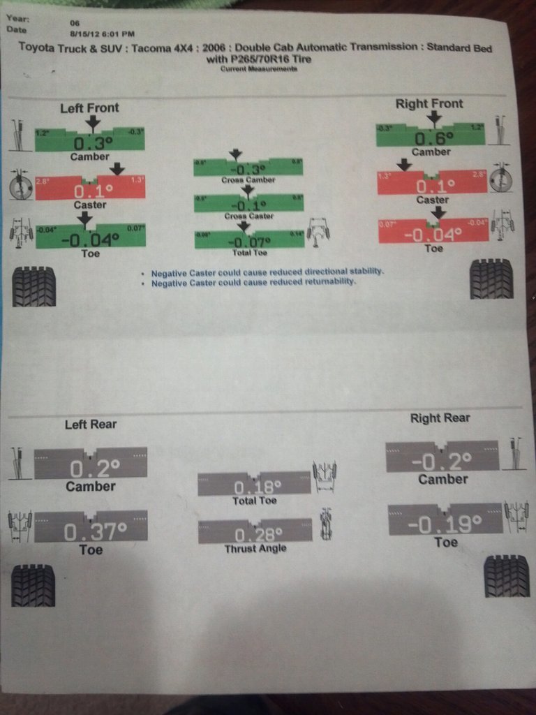

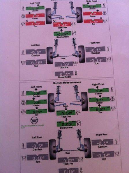

    your lower shock mount heims looked a little rough around the edges in last nights pics. they could of used a good cleaning and lubing before install.
    you need to grease the TC UCA bushings 'before' you install them. greasing them now should help. just overfill them until the bushings start bulging ever so slightly. then take short 5 minute drive to warm them up. then insert small allen key into zerk to release pressure from overfilling them. I do this once a month and after over 30k my bushings still look brand new.
    this
    looks like shit IMHO.
    should be:
    Camber 0*
    Toe 0*
    Caster 2.9*
    you also need to tell the mechanic these numbers before hand. your truck is no longer stock thus stock numbers will not work for optimum performance.

    shouldn't caster be 2.4?

    It's close, but we ain't playing horseshoes.

    Are these standard numbers for a 3" lift? Where did these originate from. I need to get mine aligned right so I stop chewing up my tires. Can this be achieved with stock UCAs?

    = or > 2.4° is bueno.

    Just gonna put this back up here, how should my truck drive like this?
