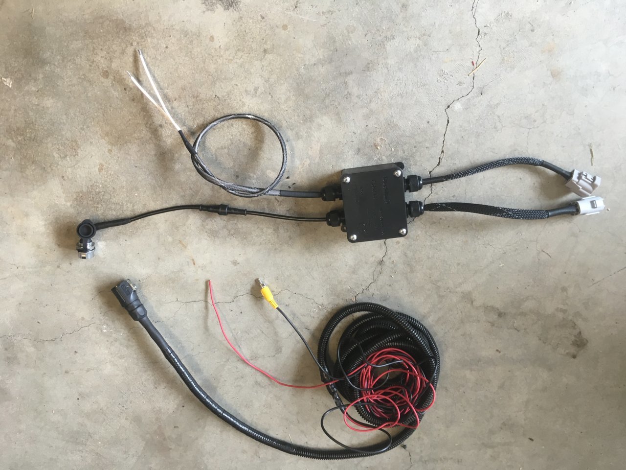

    The Automatic Trailer Camera Module and Trailer Camera Wiring Harness ready for install.

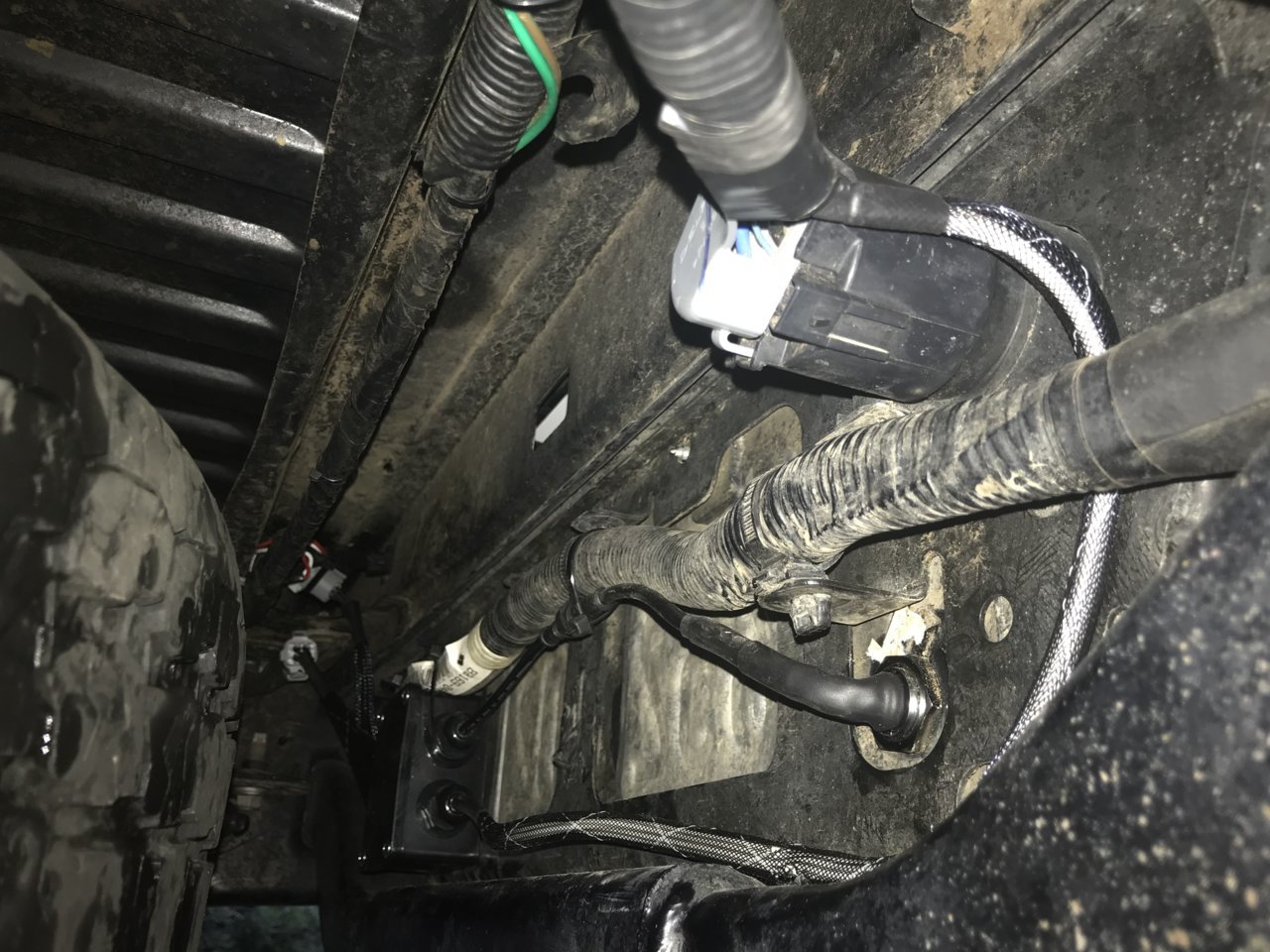

    I ran the power and ground into the Tow Package wiring loom...Used waterproof butt connectors and heat shrink for protection. (Production model will have waterproof pigtail connectors from reverse light connector on back to taillight housing. NO Splicing!)

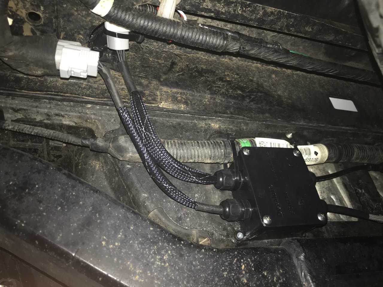

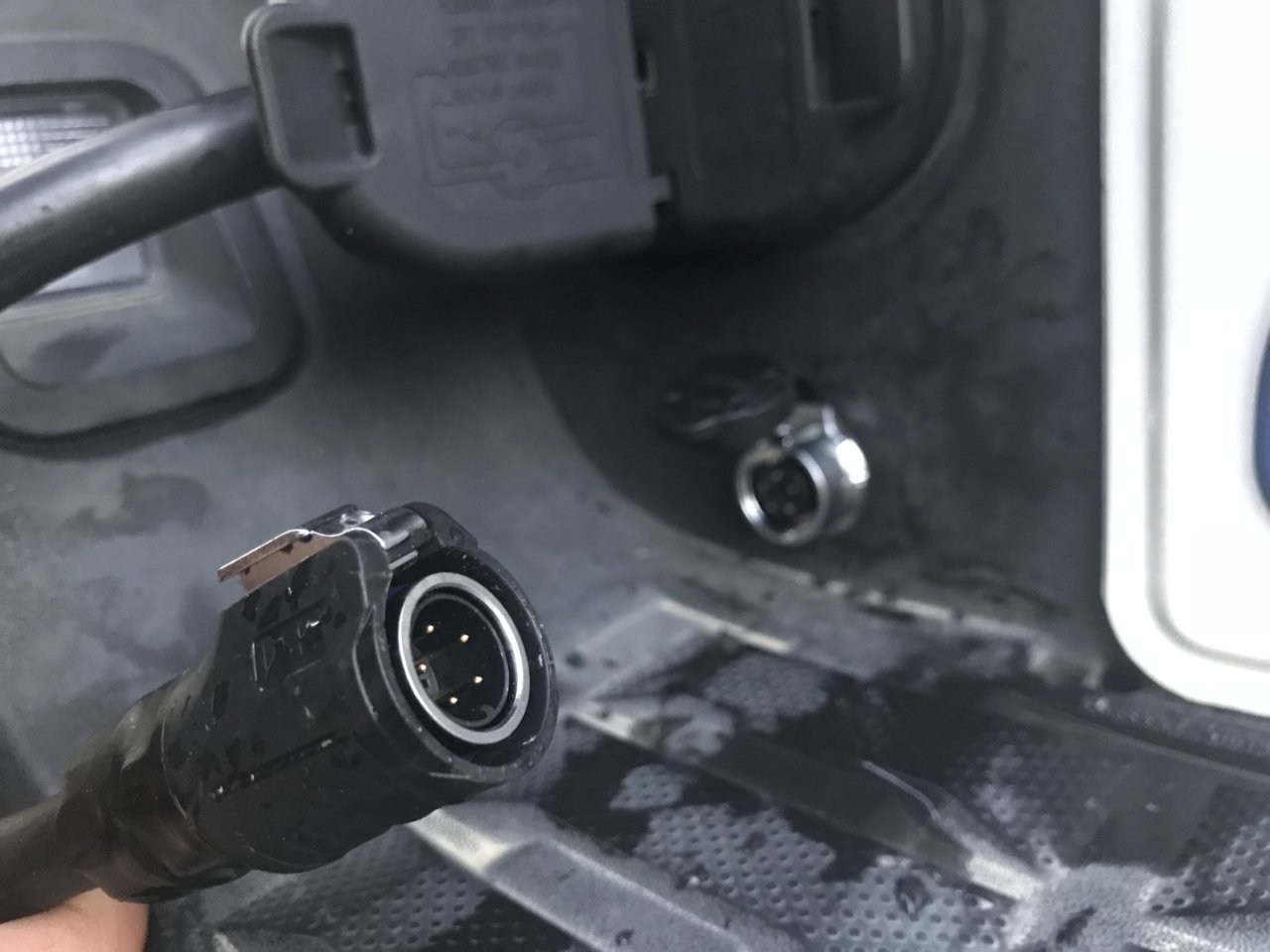

    Waterproof connectors plug in-line with the tailgate backup camera. The module can be mounted with 3m tape (I used a single sheet metal screw and zipties for the prototype)

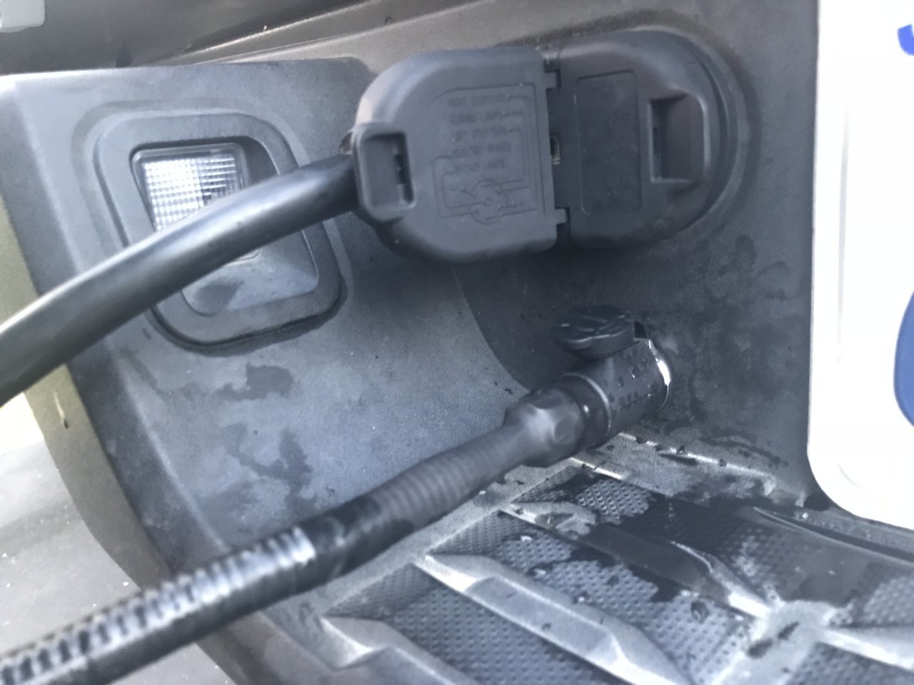

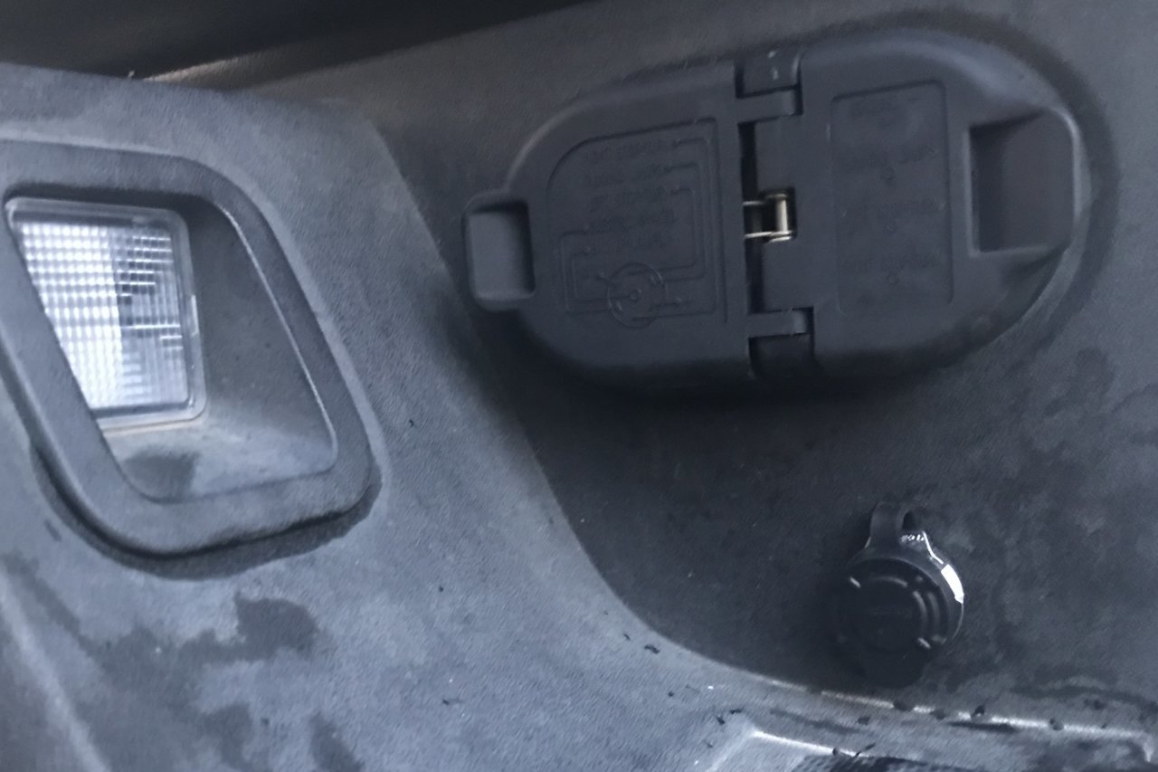

    Clean factory looking connector for the trailer camera harness.
    Waterproof IP67 rated connector for the trailer camera harness.

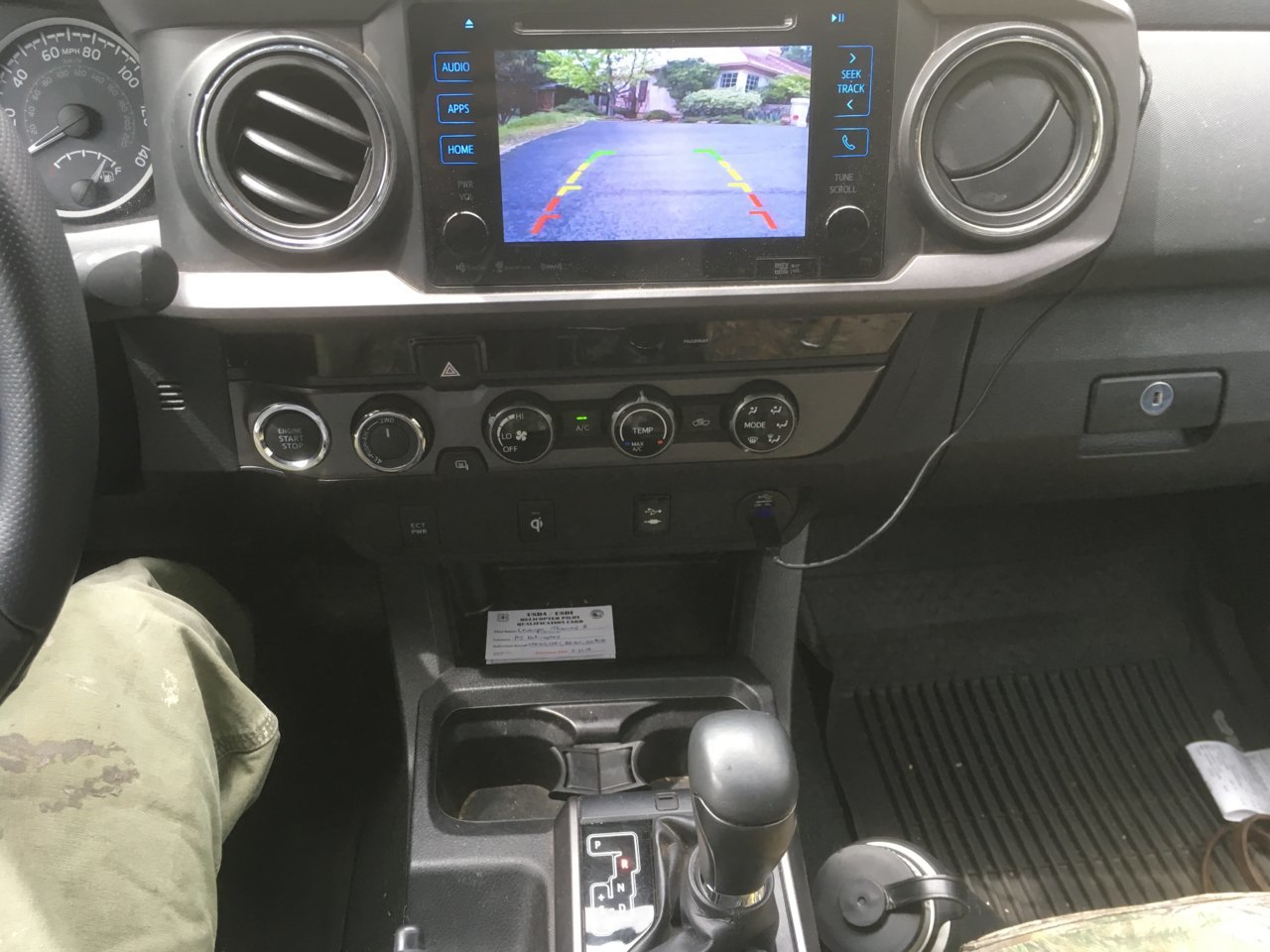

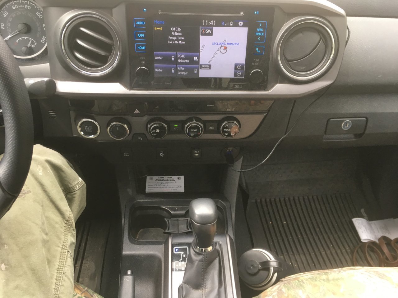

    Plugged into trailer
    In Park

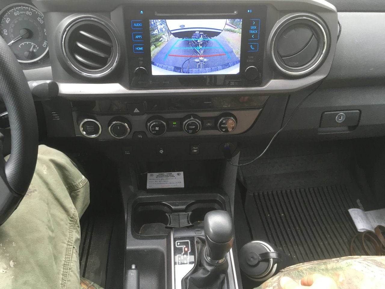

    After shifting to Reverse
    3 second delay then switches to trailer. I’ll be finding a different backup camera for my trailer as this one does not have enough of a wide angle to capture reference points.
